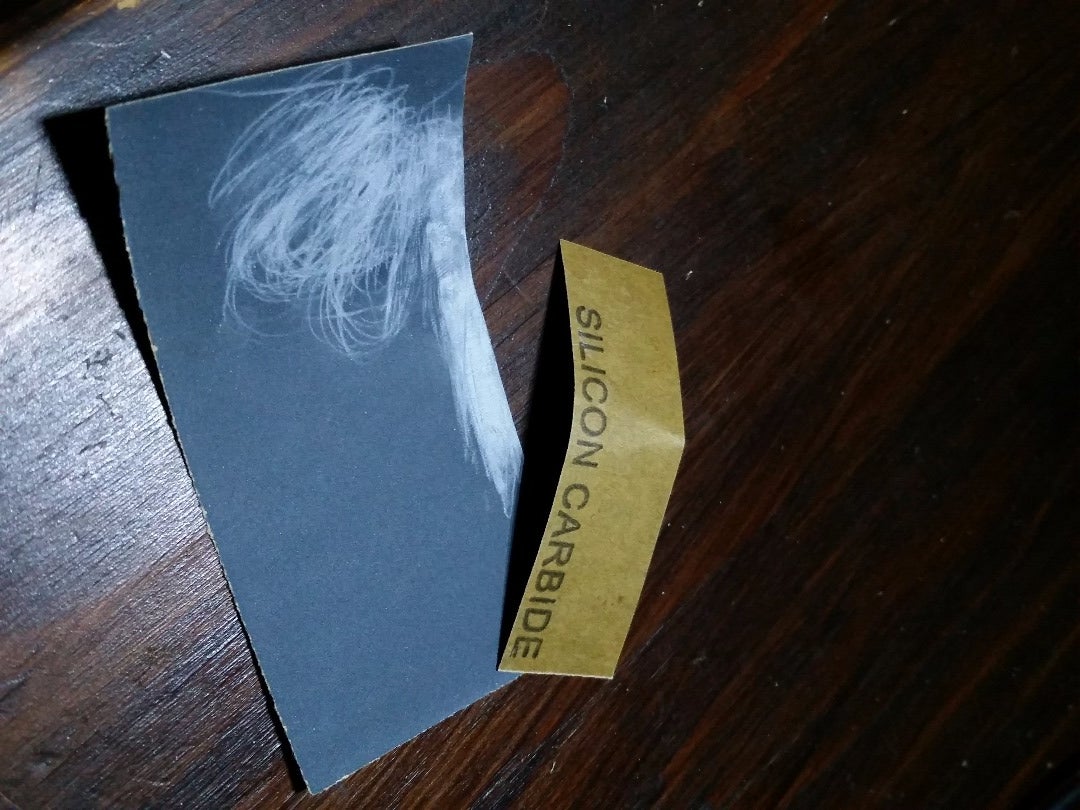

Step 1: You Will Need :
Some fine grit sanding parer. A smaller piece of abour 2 x 5 cm handles better and I found that Silicone Carbide 600 grit Waterpaper works best but anything between 500 - 800 grit should work well although the result between grits may differ (You will not be needing any water with the Waterpaper for this application tough)
A scissor maybe to cut the waterpaper with, but I just fold it over and crease the fold a few times and it just snaps of easily

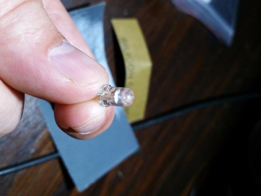

Step 2: Rubbing Part a and Part B Together
This step is self explanatory.
Hold the led by the pins right under the base for a firm and controlled grip.
You will find that you do not need to use a lot of force to get the effect started. Try to bend the sanding paper a little as you go around the led's side and sand as evenly as possible.
Wrap the paper around the led and pinch it a little while twisting the led around 3 or 4 times by the pins.
For the round top I place the sanding paper on a flat surface and with a swirling motion drag the led across it, without pressing down much on the led.
