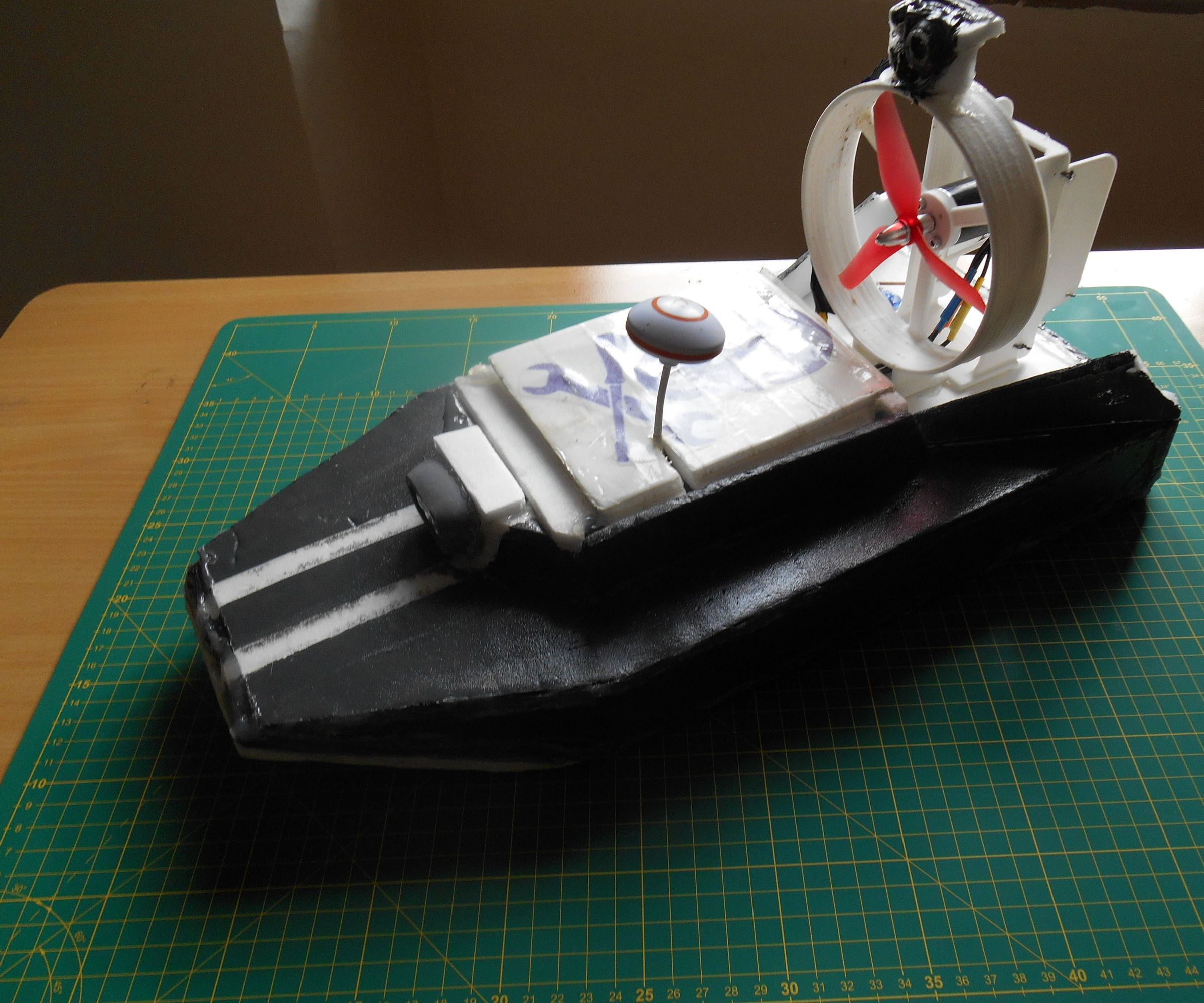

Introduction: How to Use Arduino and a RF 433 Long Range
I just explain how i have use the 433MHz RF Long Distance Transmitter / Receiver Pair and a arduino to install it on my rc truck for a firework ignition, lamp , pan tilt camera systeme .........
