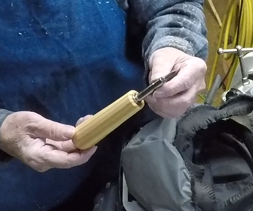

I used a tree branch and made a block that will attach to the lathe chuck.
Step 3:
Attach the waste block to the lathe chuck.
Step 4: Find Center of Project and Install It on the Lathe.
I do not apply any glue to the face of my block. I can never seem to get the part exactly perpendicular. If it is not flush with the block, it will pull away from the block and you will not be a happy camper.
Find the center of your project and use the tailstock to apply gentle pressure to the part.
You just need to apply enough pressure to gently hold the part in place.
