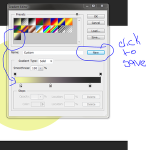

Step 9: Select Your 2nd New Layer
1.select you new layer ( naming is in option)
2. go to your gradient on in the Tool bar and click
3. Notice that your top bar changes ,there are options to create a new set of colors or work on the pre-made colors and there is in option to set the colors at an angle you prefer
4. create a new gradient > press save > new gradient added to selection
5. Now your ready to adjust your new background
SAVE YOUR WORK
