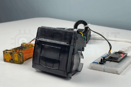

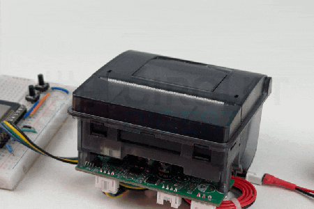

Step 1: Wiring the ESP32 to the Thermal Printer
Most thermal printers use simple serial communication and need just four wires:
  1. Printer VCC (5V) → 5V on your power supply
  2. Printer GND → GND on your ESP32 AND GND on your power supply
  3. Printer RX → ESP32 GPIO 17 (TX2)
  4. Printer TX → ESP32 GPIO 16 (RX2)
Important: do not power the printer from the ESP32 5V pin.
Do make use of a dedicated 5V / 2A supply and make sure both devices share a common ground.

Step 3: Time to Power It Up
  1. We can now power the ESP32 over USB
  2. Power the thermal printer with the separate 5V 2A supply
  3. Check the paper roll to see if it's installed the right way (thermal side up)
  4. Open the Serial Monitor
  5. Reset the ESP32
If everything is wired correctly, the printer should immediately print:
=== Thermal Printer Test ===
Hello from the ESP32!
This is a thermal printer demo.

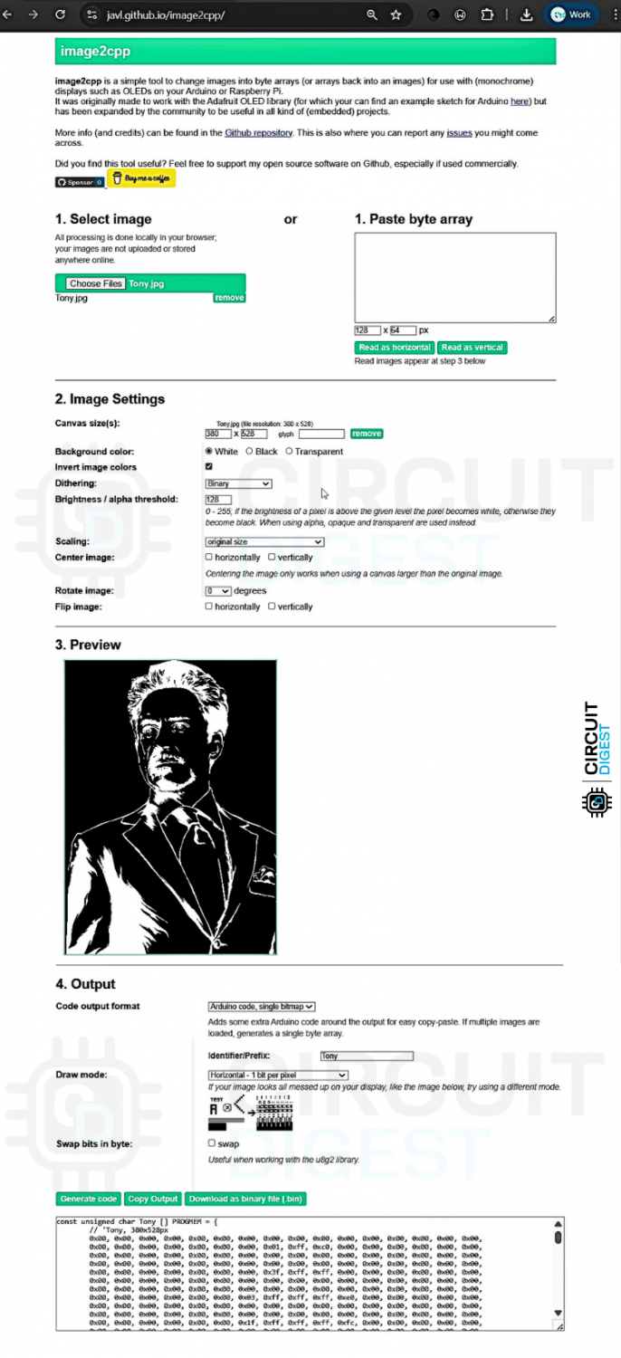

Step 5: Printing Images
If you want to get fancy and print actual images instead of just plain text, you totally can.
The easiest way is to convert a JPG/PNG into a byte array using the free online tool image2cpp (javi.github.io/image2cpp).
Here’s how:
  1. Go to the website and upload your image (keep it small, around 128×64 or 200×200 pixels)
  2. Choose “Transparent” for background and use Binary dithering
  3. Adjust the brightness/alpha threshold until the preview looks clean in black and white
  4. In Code output format, pick “Arduino code, single bitmap”
  5. Click Generate code - you’ll get a long byte array like
  6. const unsigned char imageData[] PROGMEM = { … };
Paste that array into your sketch and then send it to the printer like this:
for (int i = 0; i < sizeof(imageData); i++) {
mySerial.write(imageData[i]);
That’s literally it. The printer will draw the bitmap line-by-line.
Note: You might want to up your power supply to 6-9V to avoid faint images.
