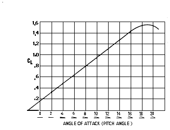

Step 4: Determine the Angle of Attack (AoA)
The chart pictured above is a standard aerodynamics chart that shows the relationship between the coefficient of lift and the bank angle of an aircraft.
Starting with your lift coefficient of .76 move across the graph to intersect the line where you will then determine your angle of attack. Your answer should turn out to be approximately 7 degrees. This demonstrates that if the 14,250 lb aircraft is traveling at 253 feet/sec with a 7 degree angle of bank, level flight will be sustained.
