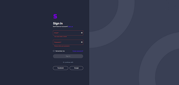

Step 1: Signing Up for SYQEL
First and foremost, we need to create a SYQEL account. Head over to syqel.com to get started and create a free account. Once you do, you will be greeted with the main page. SYQEL runs off your browser, so you don’t need to download anything.

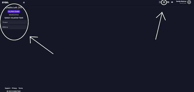

Step 2: Selecting Your Visual Engine
SYQEL offers two different visualizer engines shown on the left-hand menu. The first is Three.js, which allows you to hand-pick pre-made visuals. The second is called Milkdrop, which cycles through hundreds of thousands of visuals automatically.
Today we’ll be using Three.js, so we’ll be able to pick out our visuals.
To do so, click on the settings button in the top right menu.

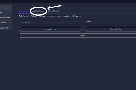

Step 3: Picking Out Your Visuals
Once you click on the settings icon, you’ll be greeted with the settings page.

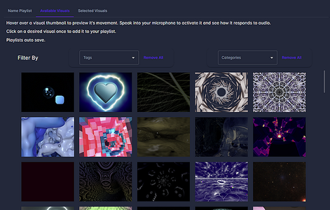

This is where you can create a new visual playlist.
1: Name a playlist or select an existing one.
2: Then, click on available visuals. Here you can scroll and see all the pre-made visuals you can use in your playlist.
3: When hovering over a visual it will animate to your microphone input.
4: Once you find a visual you like, simply click on it and it will automatically be added to your playlist.
Playlists automatically save any changes you make!

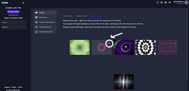

5. Next, head over to the selected visuals tab.
6. Here you can remove any visuals by clicking the small “x” on the top left of each visual or click and drag your visuals into whatever order you would like them displayed.

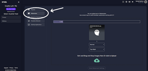

Step 4: Upload Your Watermarks
Next, head over to the watermarks section of the settings page.
1: You can upload up to 9 watermarks.
2: Choose their size and positioning.
3: Don’t forget to save your watermark settings at the bottom of the page!
You will be able to cycle through these once you have your visualizer started, so you don’t have to stop the visualizer to switch through your watermarks.

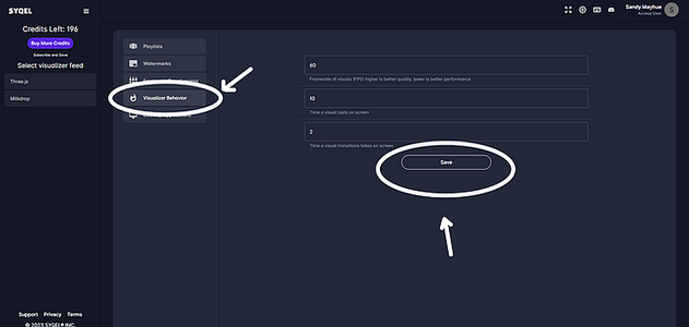

Click on the visualizer behavior section of the settings page. You will see three options.
1: The framerate of your visuals. You can set this up to 244 frames per second.
2: How many seconds each visual lasts on screen before it cycles to the next visual in your playlist.
3: How long the transition is to each visual.
Make sure you save your settings at the bottom!

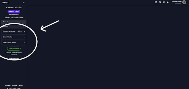

First, let’s click on Three.js in the left-hand menu of SYQEL. You will then see 3 drop-down menus appear.
1: First is your audio input which we will go over in the next step.
2: Second, you have your playlist selection.
3: Third, your audio preset selection.

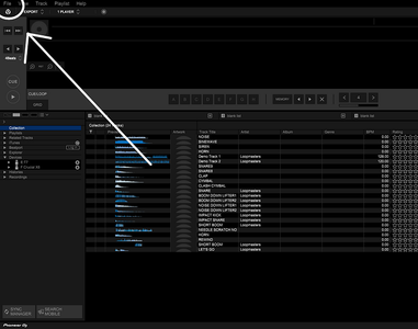

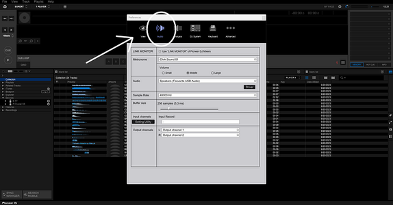

Step 9: Setting RekordBox's Audio Preferences (Windows)
1: In RekordBox, navigate to the top left and select file, preferences (both windows and mac)
2: Select the audio menu.
3: Under “Audio” select either your Desktop Audio (i.e Realtek etc.) OR use a virtual audio cable (recommended)

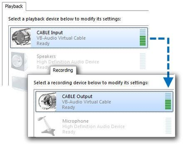

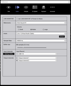

Step 10: Virtual Audio Cable (windows)
Download HERE
Once you have your cable installed (virtually!), the process is the same as above. Head to Rekordbox’s audio settings and select “virtual audio INPUT”, or “Line 1”.

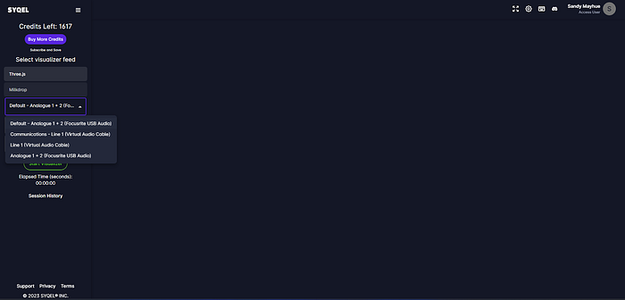

Step 11: Select Your Playlist, Audio Input, and Audio Preset in SYQEL (Windows)
Back in SYQEL, we need to select our parameters in our drop down menu.
1: Select “Line 1” Virtual audio cable as your input. (Or virtual audio cable OUTPUT
2: Then, select the playlist you created earlier.
3: Finally, if you saved any audio presets in the frequency reactiveness menu, select those here as well.

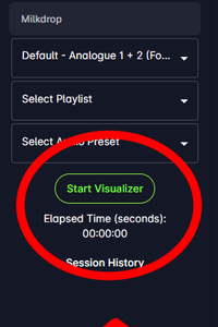

Once you have all three of your parameters selected, hit the Start Visualizer button to immediately begin the visualization.
The visualizer will start reacting to your audio as soon as any audio is playing in Rekordbox. Simply hit Stop Visualizer to stop the visualization.

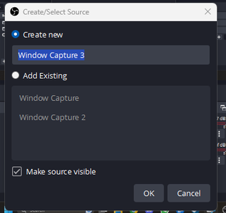

Step 14: Streaming SYQEL With OBS

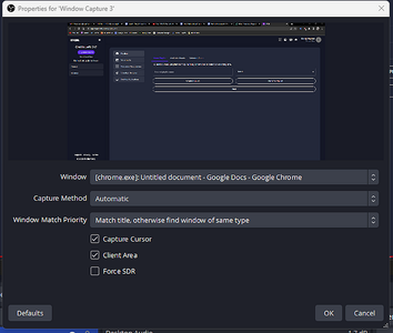

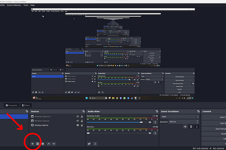

I recommend using OBS to stream SYQEL. Download HERE. It’s super easy to set up.
1:Launch OBS and create a new window capture source.
2: Select Window Capture.
3: Have Google Chrome be the source! You should see SYQEL in your new window source.

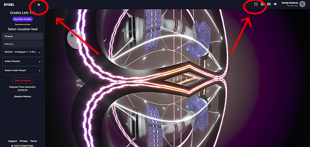

Step 15: Go Fullscreen
Back in SYQEL we can go fullscreen.
1: Hide the toolbar by pressing the hotkey “h”.
2: Click the full screen button at the top right.
3: Navigate to the top left and hit the menu button.
You are now fullscreen! OBS will be able to capture your visual full screen without any cropping.

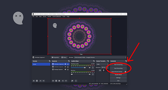

Now, we can start recording or streaming.
Step 16: Step 16: Record Your Set / Stream Your Set!
Now, with Audio coming from Rekordbox, your visual is started, and OBS is capturing SYQEL, we can hit the Start Recording or Start Streaming button in OBS! Your audio source in OBS should be the same as the audio source in SYQEL. So now you’re recording your music and your visuals with no latency.

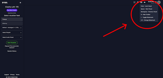

Step 17: Customizing Your Visual As It's Recording
Finally, if you want to cycle to the next visual, change watermarks, or disable your watermarks while you are recording, you can do so with the help of hotkeys!\
1: “Enter” will lock a visual in place, so it will not cycle to the next one in your playlist.
2: “Spacebar” will cycle to your next visual in your playlist.
3: “Backspace” will cycle to your previous visual in your playlist.
4: “h” as we described earlier, will toggle the toolbar at the top on or off.
5: “L” will toggle your watermarks on or off.
6: “0–9” will cycle through your uploaded watermarks.
