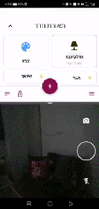

1. Download the MQTT dashboard app
2. Inside the app, add your MQTT broker (the one you have installed)
Note - you have to insert an address: tcp://(and right after insert your Duck DNS domain address)
Note 2.0 - don't forget to open the relevant ports in your router (8123 for the Home Assistant, 1883 for the MQTT broker!)
3. After connecting to the MQTT broker, feel free to add any elements should you need.
Note - make sure you define every element if it's a receiver or a giver type of an element.
Note 2.0 - the selected topic is the one you choose for the MQTT in/out.
