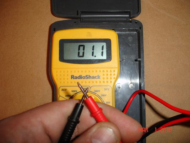

Step 5: Testing Part 1
No matter how good you are, or how certain your work, you always want to test early and often. If there are any failures in the soldering, it is much easier to correct now, before the large cable is in our way.
We will be doing continuity tests. If you're multimeter doesnt have a function for checking continuity, set it for checking resistances at its lowest setting. Just remember that infinite resistance means no connection, and almost no resistance means connected.
First, check the lines ties Low. For our SNES example, that would be pins 2-7. Place one probe on pin 1 (GND). Take the other probe and check pins 2-7 in order. Each one should show almost no resistance to pin 1.
Repeat for the High lines. For out SNES example, that would be pins 10, 11, and 15. Place one probe tip on pin 8 (VCC), and check the continuity with pins 10, 11, and 15. Each should show almost no resistance.
Lastly, check for shorts. Place one probe on pin 1, and the other on pin 8. There should be NO continuity. Infinite resistance. If these two lines are electrically connected, there is a short somewhere in your work. You MUST fix these before ever trying to use the cable. Using a shorted cable on a console may blow fuses, may cause fires, may fry your console and stick. It's bad, so fix it NOW.

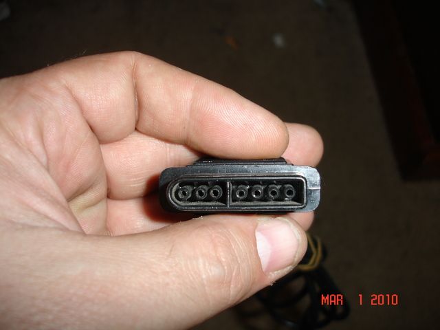

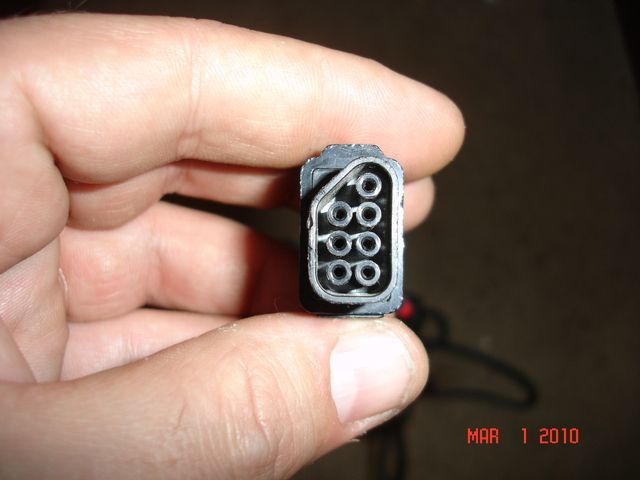

Step 6: Pinout the Console Cable
Now we need to find out what wires in the console cable do what. Once again, we need information about the console cable from the appropriate .H file.
	 ________	|1234|567)	---------		Pin		Description	1		VCC	2		Clock	3		Latch	4		Data	5		N/C	6		N/C	7		GND
If you are using an extension cable, cut the extra connector off as far from the end that plugs into the console as possible. If you are using a sacrifice controller, cut the cable as close to the game pad as possible. In either case, we can as much cable length as we can get.
Remove some cable insulation from the now-exposed end. DO NOT REMOVE TOO MUCH. You want to remove about 1" of cable insulation; enough to make sure you can solder any of the wires to any of the DB-15 pins, and leave the wires short enough that the pull-stop on the D-Sub hood is grabbing onto the thick cable insulation.
We are looking for the individual wires that make up the cable, so we can identify what each does. In our SNES example, there are only five wires actually used by the controller, and only five wires in the cable.
Each wire should be a different color. We cannot trust the wire's color to tell us anything for certain about their function, even between otherwise identical padds. We must test them against the pinout in the .H file. For this, we need a multimeter/continuity tester.
For each wire in your cable, you need to know which pin on the console connector it goes to. The SNES was a little difficult because the contacts are far inside the connector. The picture below shows me using a bare piece of wire held by a probe hook. The contact inside the connector would touch the bare wire, which touched the hook. When the other probe touched the correct wire on the other end of the cable, I would know because the resistance would drop to almost nothing. This needs to be repeated for each pin.
The picture below shows the index card I used to write down the results. I copied the pinout and pin descriptions from the .H file. When I found a matching pin and wire combination, I would write down the wire's color next to the pin.

Step 8: Testing Part 2
Now let's check all of the solder connections, as well as the wire inside the cable.
For each pin in the console plug, use a multimeter/continuity tester to check each wire and solder joint. One probe should be on the console plug end, while the other should be on the male pin of the D-Sub plug. Make sure they all work with almost no resistance between the two.
Next, re-check the system select pins. Keep one probe touching the VCC pin on the console plug, and use to other to test all of the pins that should be tied high. Make sure they all show almost no resistance. Move the probe to the GND pin on the console plug, and use the other probe to test each D-Sub pin that should be tied low.
Lastly, the dangerous short test. With one probe on the GND pin of the console plug, and the other probe on the VCC pin of the console plug, check the resistance. If the resistance is infinite, everything is good. If there is low resistance, you have a dangerous short and need to check and redo your soldering.
