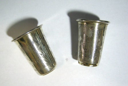

Step 3: Conclusion
As you can see in the first photo above the process partly worked and our silver stuff is only a bit cleaner.
There are two possible explanations:
-The metal you tried to clean was not silver or was partly silver.
-The process is needed to be repeated.
And as you can see in the second and third photos the cups are much cleaner now and that is because I have repeated the process once again. The advantage of this method is that it restores the "dirty" silver and does not remove it.

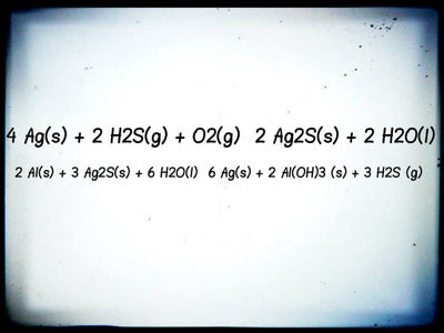

Step 4: Chemical Equitation and Explanation
Well.. in this project we see another use of Red-Ox reactions but lighting fire.
The blackened Silver phenomenon is caused by a pollutant in the air called Hydrogen sulfide (H2S) and that leads us to our first equitation:4 Ag(s) + 2 H2S(g) + O2(g) → 2 Ag2S(s) + 2 H2O(l)
This is a Red-Ox reaction between the silver to H2S, the silver turns into Ag2S and that is the "dirt" we see on the silver.
Now, in order to clean the silver we need to turn the Ag2S into Ag back again, In order to do this we will use a better reducer metal (Reducer is the substance in the reaction that gives electrons) than silver, like Aluminium, that will be oxidized, just as the silver was. The equitation here is:
2 Al(s) + 3 Ag2S(s) + 6 H2O(l) → 6 Ag(s) + 2 Al(OH)3 (s) + 3 H2S (g)
As we can see the Al starts as a solid and turns into Al(OH)3 and the silver, which started as Ag2S turns into Ag.
The scent of sulfur that is noticed during the process is the H2S's smell.
Now a question rises: why did we use Baking soda???
So Baking soda has two roles here:
Firstly, it is a cleaning substance for silver.
Secondly, the soda is a base unlike Hydrogen sulfide which is acid. The Baking soda neutralizes the acid and prevents it from hurting the silver. This happens in the reaction:
H2S (aq) + NaHCO3 (aq) -> NaHS (aq) + CO2 (g) + H2O (l)
After this reaction we're left with water, Carbon dioxide and Sodium hydrosulfide that won't harm silver.
