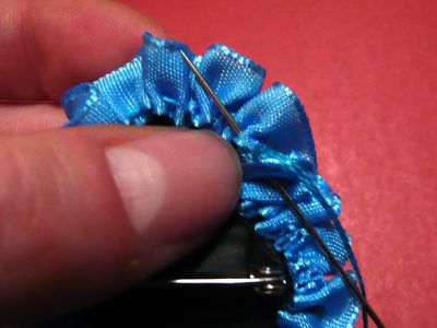

Step 9: Creating Quillings
This is optional.
A)
Take the lace and stitch with constant distances (as seen in the picture). Gently pull the lace down the thread to form quillings.
Do the same with the ribbon.
B)
Add the two sided tape at the edges of the brooch and stick down the flouncy ribbon. Repeat with the lace, but add the tape onto the base of the ribbon this time. Secure both with a few stitches through the last layer.
