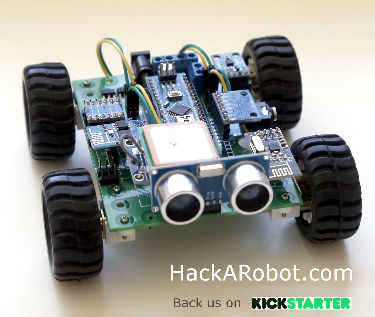

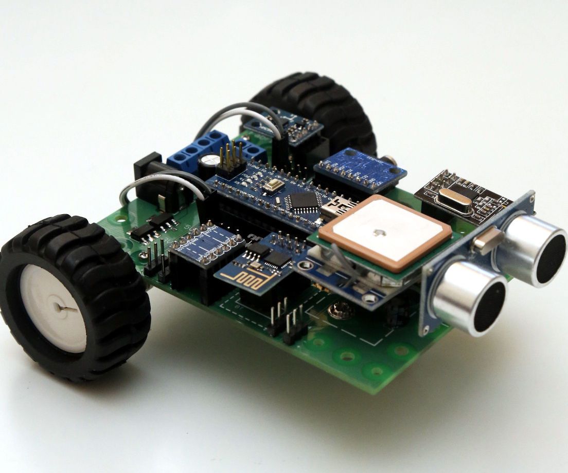

Fabric shield is not an ordinary PCB. It also serves as a robot chassis. There are holes at four corners specifically designed to attach the motors using screws.
Four digital pins (D3, D6, D9 and D10) on Arduino Nano could be used to control motors. Since motors takes a lot of current, a motor driver chip (L293D) is applied in fabric shield to provide much higher current capacity. Motors could be connected to either the header pins (highlighted in purple) or to the screw terminals. Input voltage (VIN) should match the rating of the motors, but it also needs to be 5V and above. In other words, if you use 6V DC motors, VIN needs to connect to 6V.
Step 2: Connect the Motors to Fabric Shield
Use screw driver to attach the motors and caster wheel to the back side of the fabric shield. Each motor has two wires. Connect the wires to the jumpers as shown in the diagram.
In the close-up, it shows how the pins are arranged. There are two header pins each for D6, D9, 5V and GND. This makes it easy to connect two DC motors or two servo motors using these 8 pins. Similarly, there is another group of 8 pins for D3, D10, 5V and GND to control another two DC / servo motors.

    Using the PCB as a chassis is a showstopper for me. The extra holes do not make the PCB suitable for mechanical stresses. The bending of the board is due to the torque from the wheels, the sideways position of the wheels and the distance to the ground contact are torque levers, that will put more strain on the PCB than expected. Material fatigue of the (copper on the) board will eventually happen. Diagnosing the failure of the PCB will be hard to do. Don't learn our kids the wrong engineering practices ! Propose a chassis that will take away the mechanical strain from the PCB.
