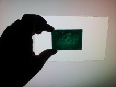

Step 6: Result(´s)
So we got first results \o/
Sadly the printer didn't want to make a fine print that evening, the pla broke while printing, but we got a acceptable result! you can see the cat! After that we changed the code a little bit, now it weill create some very fine maps for 3D printing.
