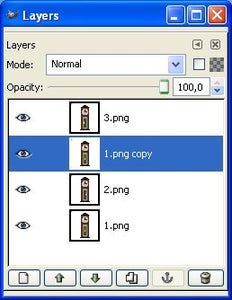

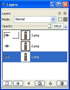

Open the GIMP. Drag the first frame onto the program's main window. It will open, as shown in the first image. Now check if the layers dialog is open. If it isn't, open it by clicking ctrl+l or going to file\dialogs\layers. Now drop second and third frame onto the first one that's already open. They will appear in the layers window, like in second picture. Only the top layer will show, by the way. Now select the first layer, and duplicate it(right click on the layer in layers window and select duplicate). Drag the duplicate between the second and third frames. It should look like image 4. We're almost done.

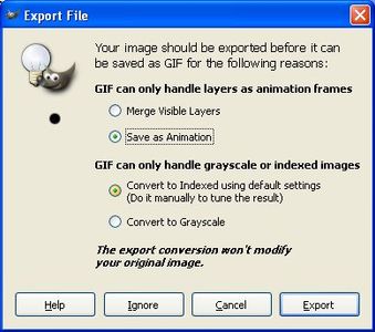

Step 6: Saving the Gif

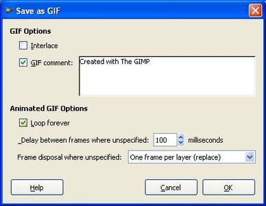

Press File\Save as..., select the file format as *.gif and press save. A window(1) should appear. Select "Save as Animation" and "Convert to indexed..." and press Export. Another window(2) will appear. Write a comment that you want, set the gif to loop forever and frame disposal as one frame per layer(replace). Set the delay to 200ms(100ms is too fast).
