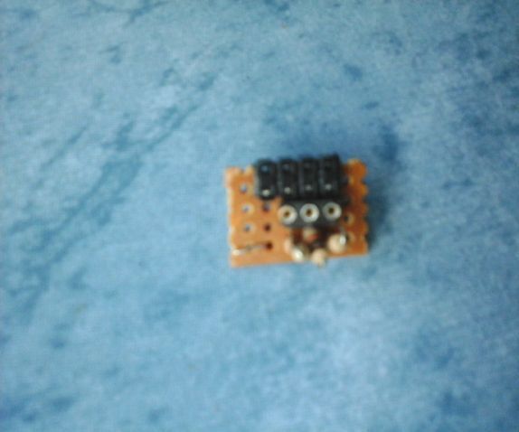

Step 2: Making PCB
Simply I design little PCB fro connect display pins to UNO board. These are the pins you want to connect with arduino board. Use above image to determine pins.

Step 3: Soldering Componets Togather
Please refer the images.
Step 4: Conecting Components
You can simply connect you created circuit board to arduino board.
