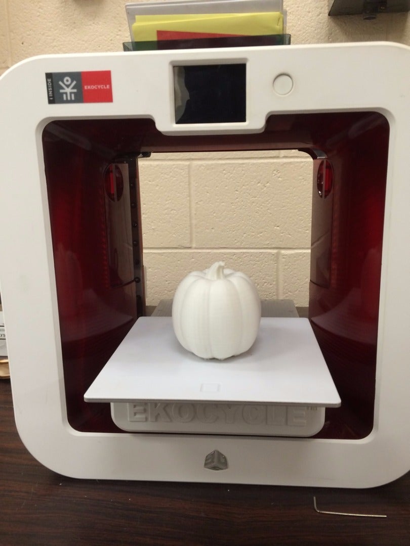

Step 1: Printing Your Object
Start off by printing any object you would like. This product was printed out of the Cube. The Cube is one of many 3D printers that you can choose from. It doesn't matter what printer you use, as long as you are absolutely positive that your printed object is ABS filament. In this case I printed a pumpkin for a fun fall feeling, but with Thanksgiving right around the corner, feel free to print a turkey. PLA is another filament that could be used to print, but that can not be shined with Acetone this way. We are using acetone vapor to leave a shiny finish on our pumpkin, if it was PLA we would need to use much more acetone because it would have to be dipped in it. That way is more expensive and potentially dangerous if there are any matches around.

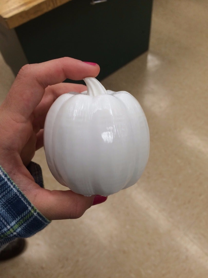

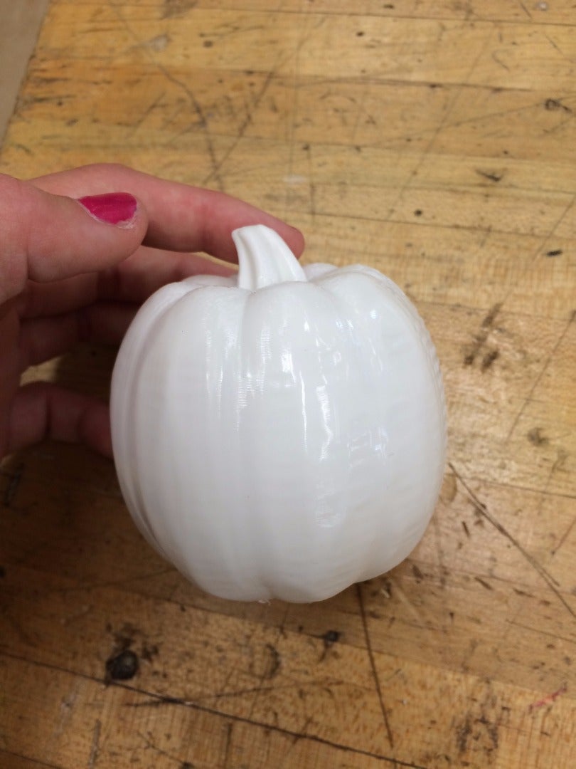

Step 4: Making the Magic Happen
After you had poured the acetone into the can, you can now complete the last step. All you have to do is cover you object with your can. MAKE SURE IT DOES NOT TOUCH THE SIDES. Leave your object underneath the can for about an hour. If you leave it there for longer that is okay! The vapor will eventually evaporate and nothing else will happen after it is completely shined. After your hour long wait and you carefully remove the can, please don't touch your object for about 20 minutes, so you can allow the ABS to absorb acetone. If you do touch it before then, you could potentially leave finger prints.
Step 5: FINISHED
If you follow all of these steps your ABS object should come out looking as fabulous as this pumpkin has.
