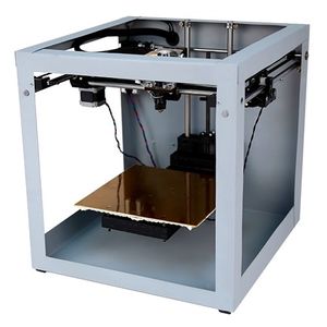

A very common problem when performing 3D printing is that the pieces are detached from the bed with the impression still ongoing. The plastics used by 3D printers requiretemperatures and a very specific flow so that everything goesperfect and it often happens that the bed and the filament of the first layers do not mix. We notice to see how the edges of the figure begins to rise reaching a height of severalmillimeters. Luckily we have a trick to improve the gripof 3D impressions on the bed in our 3D printer.

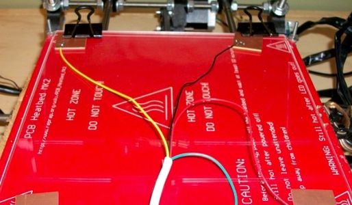

Bed temperature
Many of the programs we use in 3D printers take default values between 50 and 70 ° C for bed 3D printer, this value is variable and the interesting thing is that we change our own experience. The arc temperature can be between:
PLA: Between 20 and 90 ABS: Between 70 and 120 Bed temperature used depend on the material, including the manufacturer or exact composition. It is difficult to indicate a standard temperature so it is essential trial and error with fast print pieces to set the printer to the maximum.

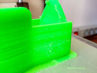

Edge or brim for better grip
The option to generate an edge that extends the base of the piece we are 3D printing is one of the best options if we are in the situation of not getting the perfect temperature for our bed, space and not to apply lacquer. The brim is a solution which subsequently give us a little more work because you have to remove the final piece but offers few millimeters added to improve the clamping surface of the workpiece in bed. Slic3r allows us to set the edge or the appropriate tab brim Print Settings> Skirt and Brim.
