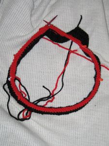

Step 1
Using the #5 needle(s) cast on 124 stitches in the black yarn.
Place a stitch marker at the beginning of the row. Join the stitches together, taking care that you don't introduce any twists.
Knit 6 rounds.
Knit the next two rows in Knit 2, Purl 2 rib. This prevents the stockinette brim from rolling up further.
When you get to the end of the second row, break the yarn leaving about 6 inches to weave in later. Begin knitting with the background color (red). Knit 3 rounds.

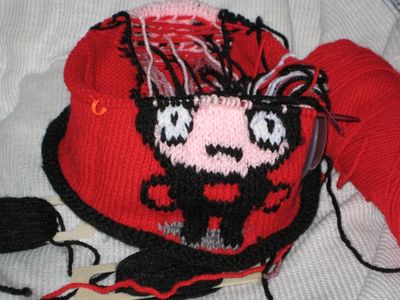

Step 2
Now it's time to start the intarsia patterns. I arbitrarily made the Garu pattern the front and the Pucca pattern the back.
The cap is basically a piece of Fair Isle with elements of intarsia. The red is worked as Fair Isle, when not being worked the red yarn is stranded in the back. When possible, twist the color of yarn you are working around the red yarn every 3-4 stitches to prevent long strands of red yarn.
All the other colors are worked as intarsia. Each block of color will have it's own bobbin.
Normally you knit intarsia blocks flat. You would normally knit the block of color and at the end of the block the bobbin of yarn would end up on the left side of the color block. When you get to end of the row you turn the work around and purl back. When you get back to color block the bobbin is waiting on the right side for you to use.
Working intarsia in the round has it's own problems. As the you knit in only one direction, after the first round the bobbin is on the far end of the color block and not available for knitting. To work around this, you have to get creative.
1. Slip as to purl all the stitches that you are going to have to knit from the left needle to the right needle.
2. Twist the red yarn around the yarn you will be working. In some sections this will create a long strand. (I will deal with this at the end by using the loose yarn ends to weave the long strands into the knitting)
3. Work the color block by knitting the stitches backwards from the right needle to the left needle. I won't explain how to "knit backwards" as there is a really good description of the process on Knitty: http://knitty.com/ISSUEsummer06/FEATreverse.html
4. Slip as if to purl the knitted stitches from the left needle back to the right. You are now ready to proceed knitting with the next color.
When you return back to that block of color, the bobbin of yarn will be waiting for you. You will have to do the slipping and "backward knitting" every other row, while working the pattern.
