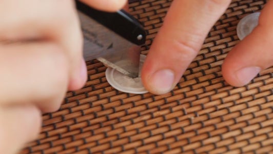

Step 3: Assemble the Pad
1. Cut an “X” in the center of the lining to make a hole, no larger than 1cm on each line.
2. Then insert a size-3 nickel-plated brass sewing snap into it.
3. Trim the tiny corners of plastic from the edge of the button nub to help expose it more.
Congratulations, you made an ECG pad. They’re washable and reusable up to 100 times or so. See the last step for directions for use.
