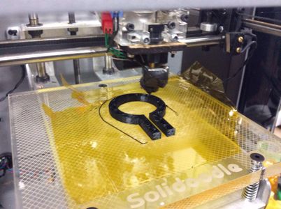

Print out the projector attachment using 3D printer.
The wood we used is plywood panel with dimensions 910mm x 1820mm x 12mm(we used three pieces).
