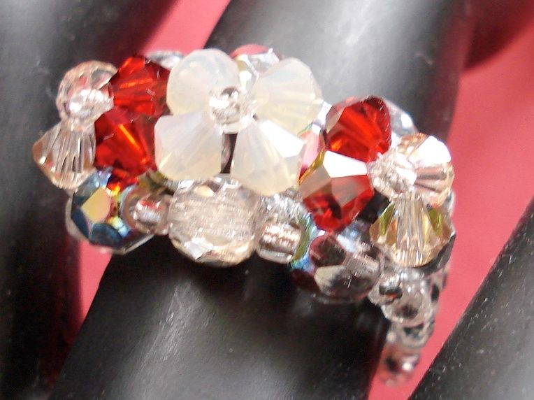

Step 1: Starting With the Base of Swarovski Crystal Rings
Base of Swarovski Crystal Rings (Step 1)
1. Thread 2 needles with nylon, adding 3 of the Czech beads, add the 4th bead to one of the threads, then cross other needle through it as well. It should look like 4 beads, like a miniature square.
2. Add 1 Czech bead on a needle picture below top left bead, then add another bead the bottom of the three cross through with the other needle, making sure threads come out bottom of the three on either end..
3. Next is the middle row with 3 flowers in a row, making up 4 beads in each.
4. Last row has 2 lots of 4 beads then the same as top left of first picture, the 3 beads, add 2 beads then cross through the 3 bead.

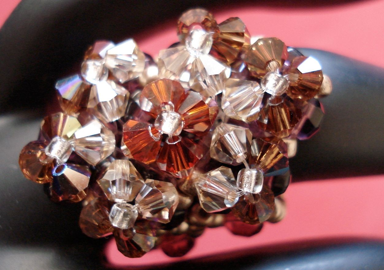

Step 2: Starting the Top Swarovski Crystal Rings
Top of Swarovski Crystal Rings
1. Start with 2 needles with thread threaded through both. On thread from top left side of square add 1 Swarovski Crystal Bead plus a seed bead, add 1 more crystal, threading from left side to right side of first little square, going through right of the bottom base Czech bead.
2. Take other needle from right side of square add 1 Swarovski Crystal Bead color go through seed bead (of step 1), add the second bead, now go through left side Czech bead on base.
3. Following this pattern complete 2 flowers. Then for the end one of 3 beads, add 1 crystal bead each on the needle, then add one silver crystal like picture below, the opposite needle needs to thread through it as well, go through Czech beads underneath, opposite ones for each needle, you can see nylon coming through below.
4. Do the next row of 3 4flowers, then the last row which is like the 1st row just the opposite way around with the 3 beads being on the right hand side here. I would sew through all the crystals again, strengthening top crystals.
5. Knot the 2 threads together in centre of base of Czech beads, underneath, add a dollop of cement/glue. Tidy up by sewing threads into base.
Step 3: Finishing Heart-shaped Crystal Rings
Finishing off the Swarovski Crystal Ring
To finish either use seed beads or silver beads to go around the edges filling in. Go through all beads again to strengthen crystal ring. Make a knot underneath and sew through other beads. (Crystal Ring back view)

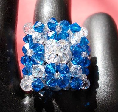

Step 4: How the Heart-shaped Swarovski Crystal Rings Looks Finished
Swarovski Crystal Rings band
To do the band, using either the seed beads or silver beads, feed 2 beads on either end of thread, then another 2 beads and go through them, carry on until you have the right length, with the silver beads, I did 6 links plus the 2 beads on either side of Czech bead.
This is the finished product, enjoy making your Swarovski Crystal Rings wow everyone with your creativity, shining in this beautiful ring.
