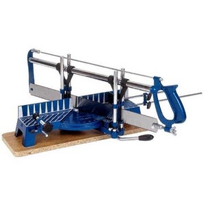

A Tab saw ( don't know if it's the right word >< )

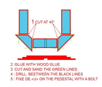

The pedestal is made with the scrap wood of previous wood ring PICTURE 1
Use the wood cleat to make the "U" part which will be articulate with a simple bolt.
I've made a quick plan to explain how to make the "U" wood part i hope it's clear enough.
