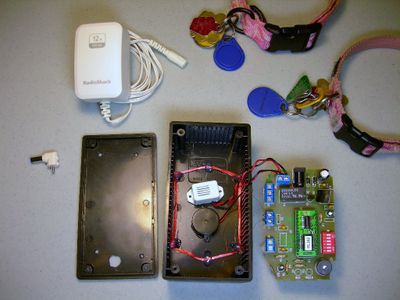

Step 1: Materials and Tools
Materials

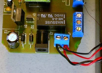

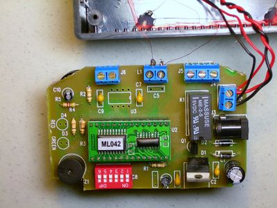

- KL042 Proximity Card Access Control Kit
- SK02 - 125 kHz Proximity Key Fob
- The smallest quantity sold is a 10 pack. I asked QKits if they would substitute the access cards that come with the kit for the key fobs, and they did... I'm not sure if this was a "one off" case, but it doesn't hurt to ask. If they won't do this for you try contacting AVEA, the mfgr of the kit and see if you can purchase from them.
- Radio Shack 500mA AC to 12VDC Adapter
- This comes with one adaptaplug tip. Make sure to get the adaptaplug M with the blue tip.
- Project box
- The dimensions of the box I used are 13cm x 7cm and was purchased at a local electronics dealer, but you can also buy them at Radio Shack.

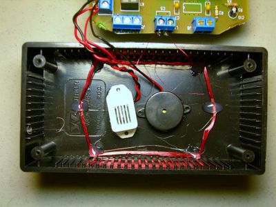

- The KL042 circuit board can be cut down to a min. size of 9cm x 5.7cm, so make sure your box is at least this size PLUS the dimension of your adaptaplug and buzzers.
- Annoying buzzer(s)
- Also available at Radio Shack
- Wire or L-Bracket
- Used to secure the box to the food bowl. I bent one side of an l-bracket to make a hook shape.

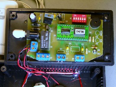

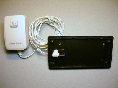

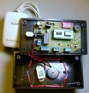

Step 2: Assembly

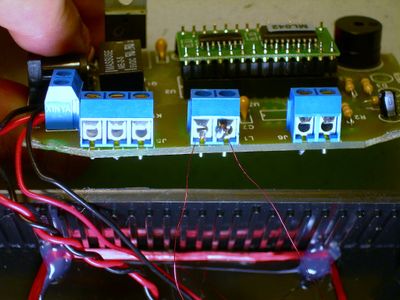

There isn't much to this step. If you purchased the unassembled version of the kit, consult the diagram that's included with the kit and put it together.
Then, have a look at the pictures below to put it all together.
Before you close the box, program the RFID key fobs via the DIP switches. Consult the manual that comes with the kit for this.
You need to program the RFID key fobs that DO NOT have access to the bowl. This way, when the pet who DOES have access to the bowl tries to eat nothing will happen... but when a pet who DOES NOT have access to the bowl, a successful read will occur and the buzzers will sound.

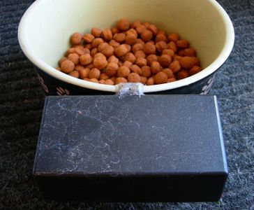

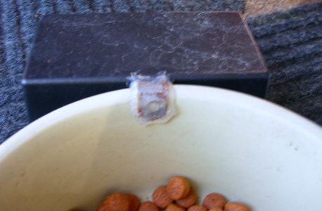

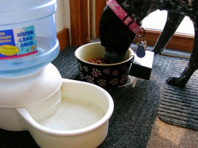

Step 3: Attachment and Positioning

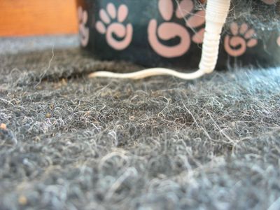

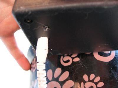

I used the modified l-bracket I mentioned in step 1 to attach the box to to the bowl. Of course, you can do whatever you want.
Then I cut a slit in the charcoal colored mat and ran the power cord underneath for safety reasons.
All that's left to do is position the box so the key fob hovers over the box while the dog eats!
