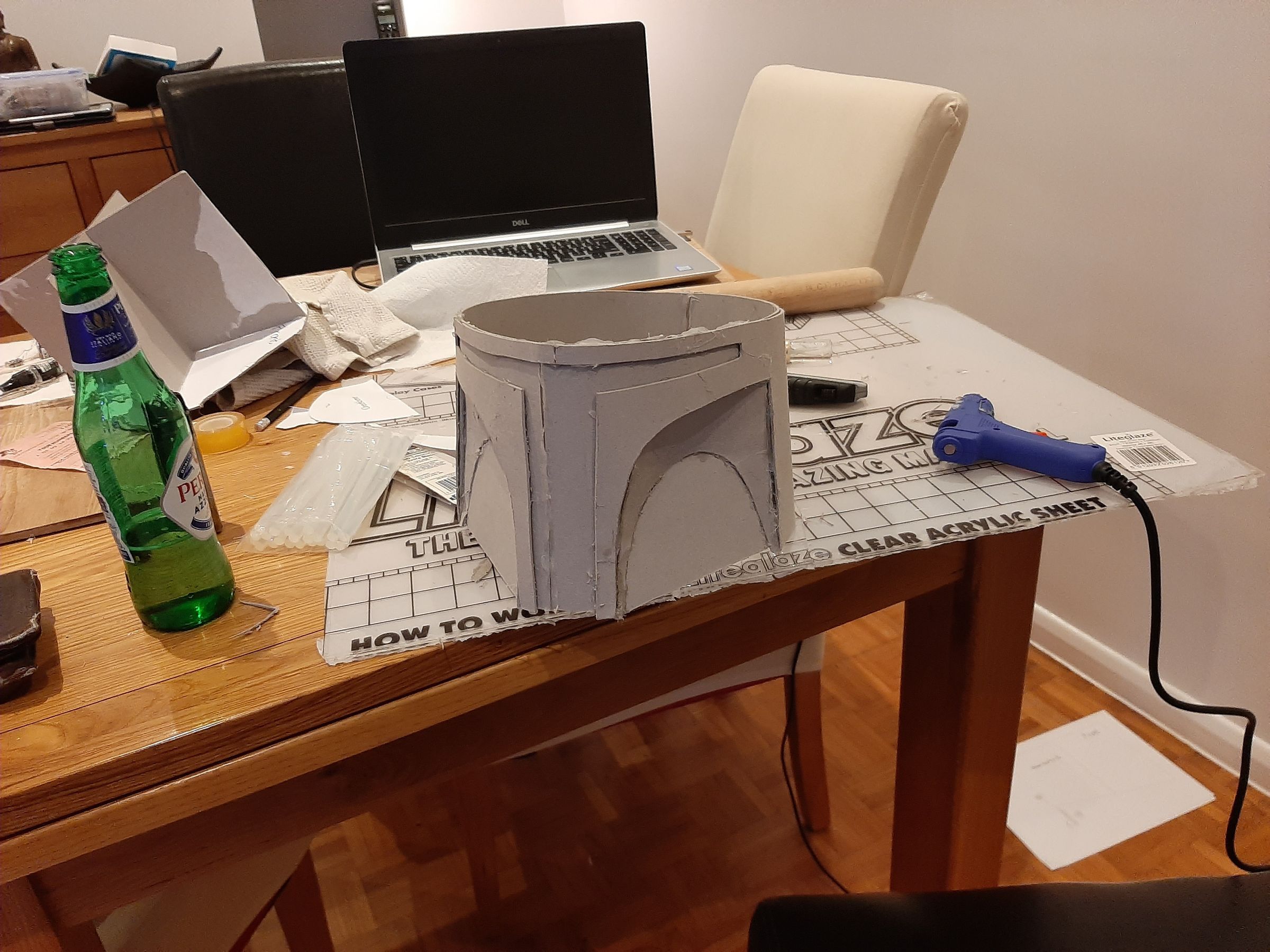

The first step is to make the form for the helmet base. This is used to help establish the basic helmet shape and is later removed from the helmet. The form is made from templates pages 4, 8, 11 and 12. The patterns on page 4 and 8 are glued together by cutting a slot in each piece on the center line and then fitting them together. Join the patterns on pages 11 and 12 together and cut them from a single piece of cardboard and then glue that piece to the patterns from pages 4 and 8.
Now make the inner helmet surface. This is done by cutting out the patterns on pages 18, 14,17 and 13, taping them together and cutting them from a single piece of cardboard. This single piece is then wrapped around the helmet base form. Getting the cardboard slightly damp (use a misting spray bottle) will make it easier to bend. Then I epoxy the joint at the back of the helmet.
Next make the helmet outer surface- it is made the same way as the inner surface and is wrapped around and glued to the inner surface. Once the glue is dry cut out the cheekbone sections on the helmet inner surface. Now make the cheekbone sections by gluing the cheekbone template parts together and bending the cardboard and tacking it into place using a glue gun. I only use the glue gun on the inside of the helmet. Then I smear white glue over all the joints on the outside of the helmet.

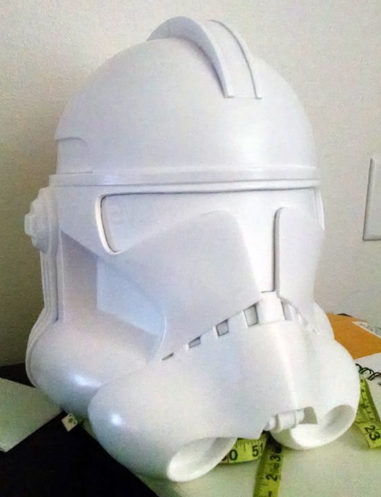

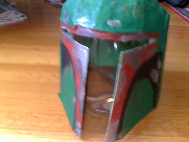

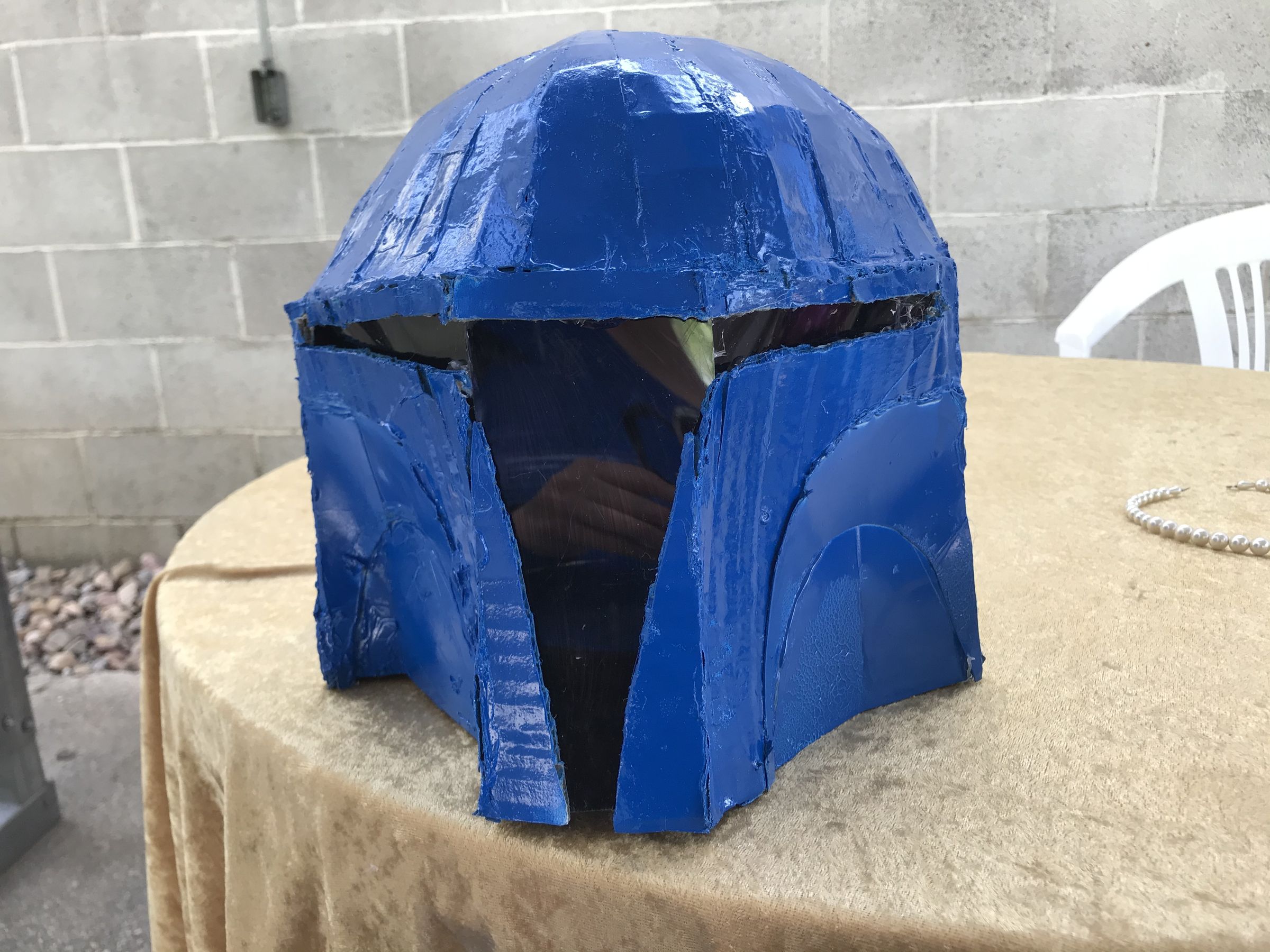

so finished the helmet(had alot of fun building it).im trying to build this helmet.do u think i should use the newpapaer board or should i use a boba fett helmet as a base and paper mache from there on.

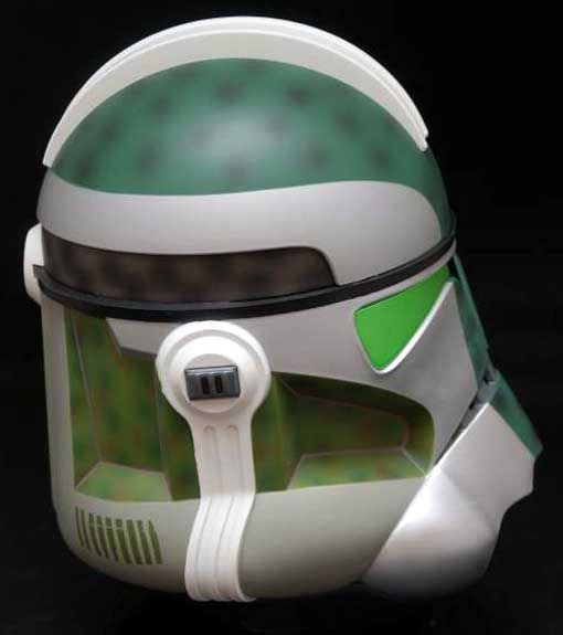

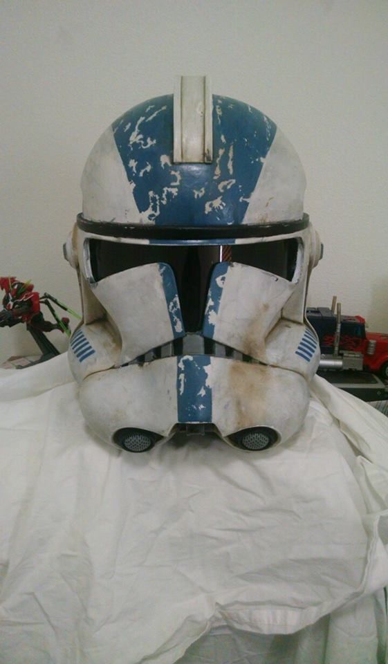

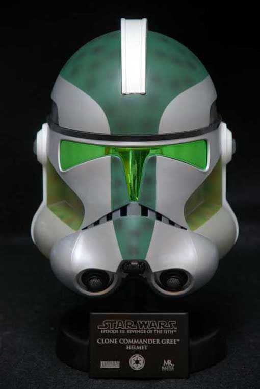

Depending on the amount of work you want to do, you can A. buy one from a dealer for about 140 dollars on the clone trooper forums. B. use Pepakura cut out all the parts, then fiberglass/resin them together bondo the whole thing. Or C. sculpt one from clay then cast it and end up with one as produced by method A.
If you really want one my recommendation is to contact Evo3 he's a fantastic bucket maker he made mine as seen in my photo. The first image is the blank he sent me the second is my paint job.

I think it was 140, for the blank. I spent about 20 hours on and off painting to get all the weathering and details along with taping masking etc.

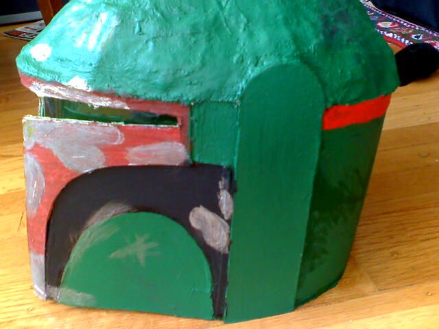

Here is my helmet i used the cardboard at the bottom but used plaster for the top

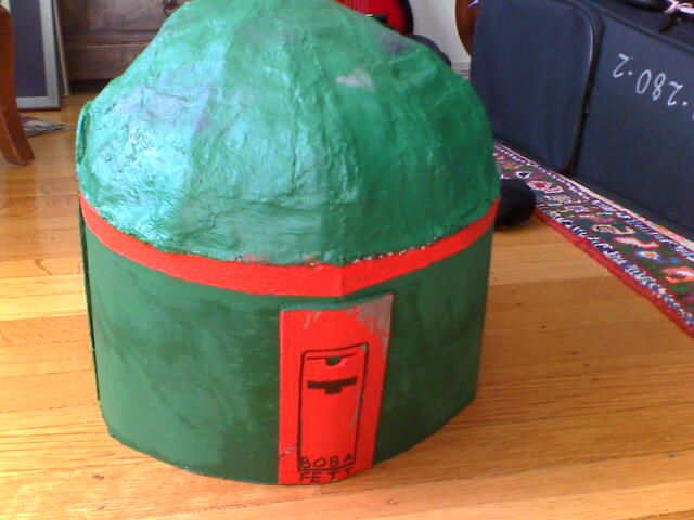

I see the dome of the helmet looks to be tricky. I measured around the boba fett helmet and then blew up a balloon to that size. then i paper machete the balloon. it worked great and was so easy compared to all those triangles.
