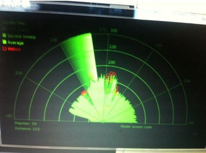

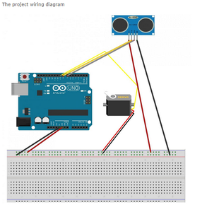

i see many project on net about ultrasonic radar system ....finally i made this here i share this project with you which is easy to make with ultrasonic sensor arduino and servo motor ....follow the step ...
part to be required
1.arduino microcontroller uno
2. servo motor
3. ultrasonic sensor
4.basic stucture to mount
5. jumper wires
6.arduino ide

Step 1: Make a Bread Board Circuit and Rigid Structure to Mount Arduino Board ..

first upload the arduino program to arduino board
open processing ide ....
copy past the program i give here for processing .....and press play button ...
if everything is ok then you will see the radar screen as shown in above figure.....

    I cant get the processing code to display anything but a static image it doesn't show anything even when i put my hand in front of the sensor

    the processing software isn,t working pls reply soon
