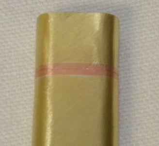

Out of the pickle I use the plug not on the drive, with some instant krazy glue to keep the cap & main body together. Once solidly together grind, file, or sand the copper plates smooth with the contours of the brass tubes. This is where the thickness of the tube makes the difference. If you were slightly off before with the alignment of the cap, & body you can file them more to match if the tubing is thicker. I like to drill out a small hole in between the cap & the main body of the drive. I do this so I can add a small bit of silver to the cap. This makes the cap only fit one way.

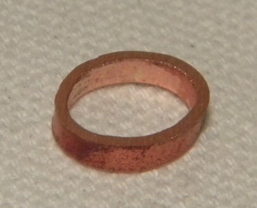

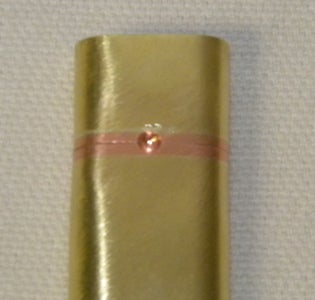

To find the place to drill for the light of the LED to lay the drive on the top of the housing in the place it would be inside. Scrape a mark in the tube & set the drive aside. Drill a small hole, & check the placement of the hole by putting the drive in. Take the drive out. Use a strip of copper to make a bezel for the stone. Solder the bezel to the housing. Drill out the brass more leaving a small amount for the stone to sit on.

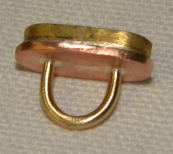

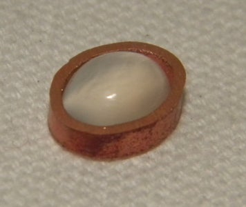

At this point the drive is a plank slate. You can make into just about anything. I added a few wires to give it a little character. I also added silver strips to the back of the of both the cap & main housing. This will allow the owner to wear it on a necklace with out oxidizing as easily. When you have added the last bit to make your drive more interesting, no more using the torch, it is time to set the stone. Place the stone in & smooth the bezel down. There a few places to look up how to do that, so I won’t get into it.
