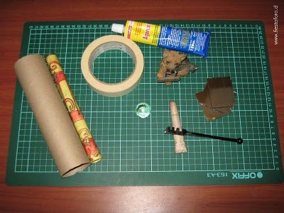

Step 1: Materials
The tools and materials should not be difficult to obtain. I think the most difficult or expensive is the glass cutter.
In addition, you will need a spare piece of mirror (depending on the size of the teleidoscope, around 15x10 cms).
Finally obtain the glass ball. It looks opaque when it is close to you, but at around 20 cms (1 foot) it converges light.
Glasscutter & lubricant (cooking oil)
Glass (three 15x2cm pieces)
Transparent glass ball
Paper or duct tape
In the picture, you can see more materials you may need, such as glue and cardboard tubes.
Paper or duct tape

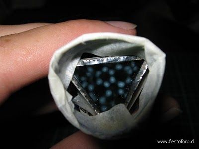

Step 4: Mirror Internal Arrangement
With paper tape or duct tape, arrange the mirrors as shown in the picture, with a little separation between them, for future bending.
Bent the set and try to form a triangular shape, with the three pieces.
Cover the whole structure for extra strength.
Step 5: Outer Layer
Finally, wrap the triangular structure and the ball, so that you know how much paper is needed to protect the teleidoscope.
I only used thick paper to cover my teleidoscope. You can use decoration paper or other fancy wrap, but remember what matter is inside!
