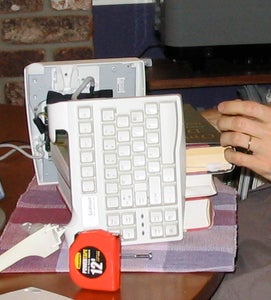

With the bottom half of the case removed, free the wire connecting the two sections of the keyboard. Using some books, or whatever you have, position the two half approximately how you would use them. I went for shoulder width apart. With the thickness of the keyboard itself, this yielded 10 inches between the two sections.
Luckily, there seems to be just enough extra wire to accommodate this positioning.
Type for a little bit to convince yourself this isn't a totally crazy idea.

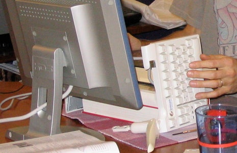

Step 5: Try This First -- Argh! It's Terrible.
At first, I thought perfectly vertical would be just fine. So, I measured, cut, and screwed into the bottom of the case two 2x4s.
The resulting keyboard position was terrible, as you can see by the bent wrists required to use it. So, I knew that I needed it to be adjustable.

I held my hands at neutral, had someone measure their position, and then adjusted the keyboard into that position.
