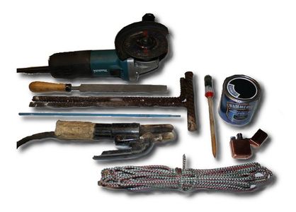

Step 6: Instruments and Materials
1.Angle grinder
2.Hand greender
3.Arc welding machine
4.Electrodes 3mm - 4st
5.Paint brush
6.Paint for rust metal
7.Color rope 20 m
8.Fire starter to frit rope's ends
9.Steel rods 12 mm - 2 m
10. Steel rods for hooks 8mm - 0.5 m
11.Weld seams hummer
12.Iron table or welding place
13.Two pipes for bending
14. 3-4 hours of free time
