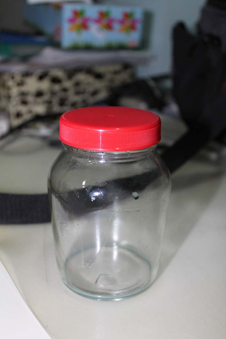

1. glass jar with lid (preferably tight-sealing)

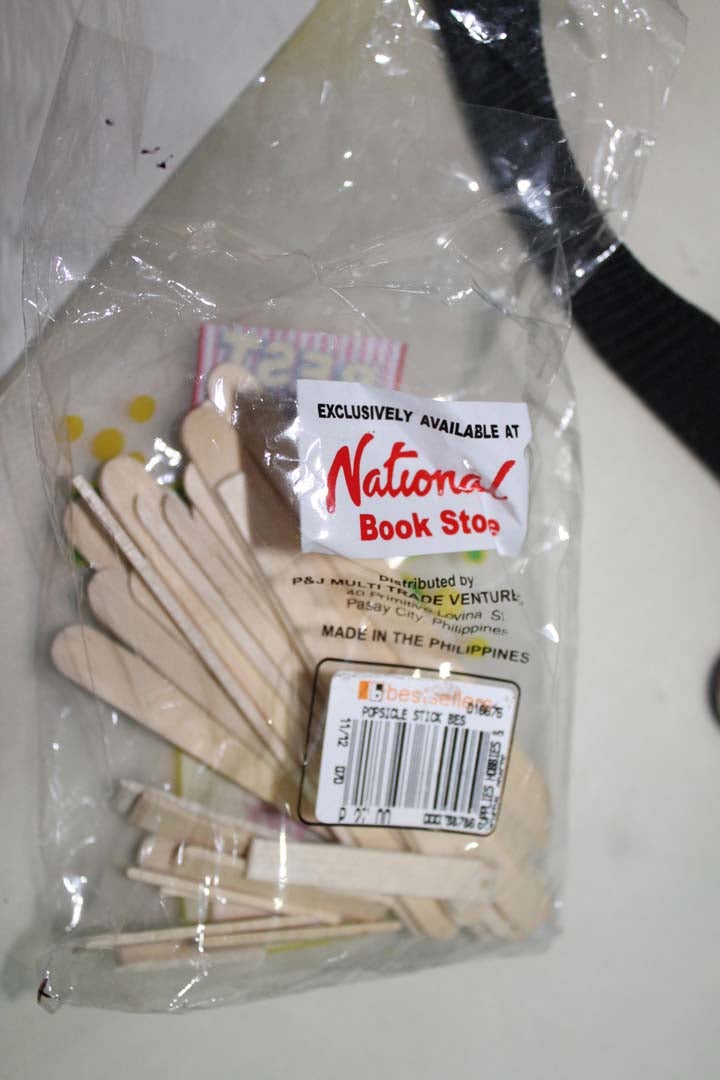

3. mixing stick, or any sort of stick that can be used to mix substances (ex. popsicle sticks)

Tear or cut your styrofoam into small pieces and place them in a jar.
