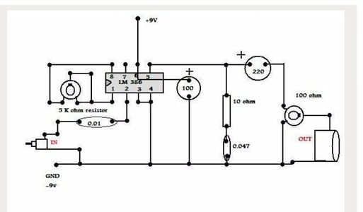

First of all you should make the amplifier but I want to tell you that this circuit of the amplifier is made by someone else and is also available as another instructable on this site. I can assure you that this circuit works coz I have built it myself. It is a mono amplifier but you can make two of them one for left and one for right speaker. The things that you will need are
LM386 ic
Ceramic capacitor 0.01 uf (number 103)
Ceramic capacitor 0.47 uf (number 473)
10 ohm 1/4 watt resistor
5 k ohms potentiometer (for gain control)
100 ohms potentiometer  (for volume control)
100 uf electrolyte capacitor
220 uf electrolyte capacitor (for bass)
3.5mm pin
3.5mm jack
The 3.5mm pin has three pins in it the longest one is the negative for both left and right speaker and one of the small pins is positive for  left speaker and the other is the positive for the right speaker. It is very loud if powered by 12v dc. The circuit is given in this step and a photo of the amplifier made is also given in this step
