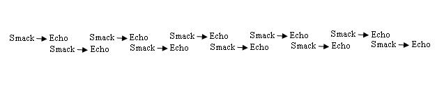

The person generating the sound should smack the lumps of wood together. After a short time, an echo will be heard. You should immediately notice that the time between SMACK and ECHO is too short to measure manually, so we will make it longer.
The wood-smacker needs to create a rhythm, so that they generate a SMACK at the exact moment they hear the ECHO. Listeners close to the wood-smacker should not be able to tell SMACK from ECHO.
As soon as the wood-smacker has his rhythm, the timers should get ready. Working together, they all start their stop-watches on the same SMACK/CRACK sound. They then count ten more SMACK/CRACKS, and stop the stop watches as soon as they hear the tenth SMACK/CRACK after the starting one. That is, eleven SMACK/CRACKS, with ten time intervals in between.
The group has, therefore, effectively timed the sound travelling over a distance ten times greater than the distance to the wall and back.
