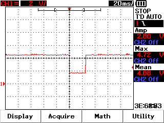

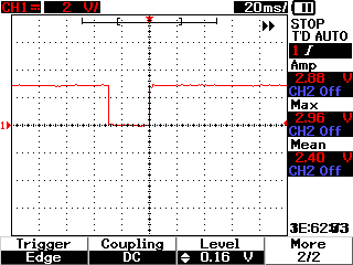

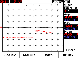

I decided that I needed to figure out what the difference was between the triggers and the camera hot shoe. I disassembled one of the triggers and the transmitter and measured the trigger pulse of the camera and the trigger pulse of the flash trigger. What I found was that the flash triggers pulse did not drop all the way to zero volts like the camera flash did, it always dropped to two. This is due to a rectifier bridge that was placed in line between the shoe connector and the switching transistor. Looking up the data sheet for the bridge revealed a forward voltage of 1v for each diode. Eureka! I decided to move the hot shoe to the DC side of the rectifier and leave the PC connector on the AC side to maintain the safety that was designed in for AC studio flashes.
