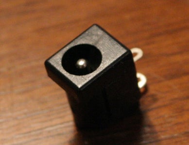

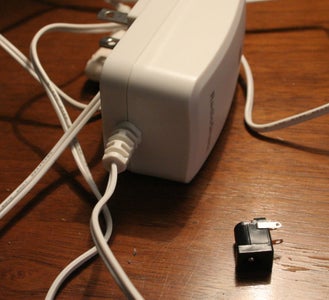

9V AC/DC power adapter with over 270mA
Female adapter for that power supply (device specific)

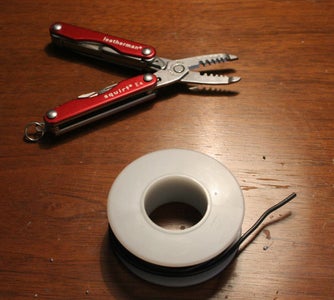

Phillips head screw driver
Wire stripper (you can use your teeth)

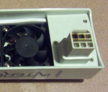

Unscrew the Nyko in the back and remove all its guts. There'll be a bunch of screws, the packing and a power adapter thing.
You'll be left with the power source adapter connected by two wires form the fans. One wire is 3 red wires connected and the other is the black ground wire. Cut both of them at the tips.

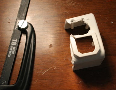

Ok. So, I originally though that you could just drill another hole in the back of the Nyko to fit the 360's power supply. Well, it doesn't fit. That's why there's a huge hole in it in the picture (below).
The best thing to do is to cut the bottom portion of the Nyko adapter off. Saw it off right above the old power supply hole. In other words, cut off the piece below the fans!

Connect the wires to the female adapter
Expose ends of your wire and the Nyko wire, and wrap your wire around the Nyko's wires. Okay that doesn't make any sense... just look at the picture! Do the same to the female adapter.

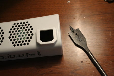

Alternatively, you can also drill a hole into the side of the Nyko big enough for the female adapter to stick through. This way you won't have all those wires hanging out. I didn't have my drill anymore, so my setup will suffice for now.
