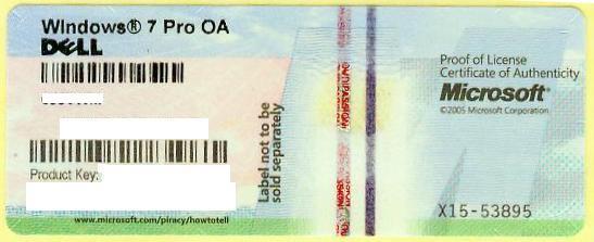

- Note your Windows product key (should be on a sticker affixed on your PC [ as shown above] or in your PC documentation)
- Note any product key's for other programs you have purchased such as Microsoft Office

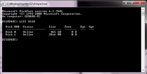

On your PC, run command prompt as administrator.
Type:
DISKPART <ENTER>
This will launch the disk partition program. Then type:
LIST DISK <ENTER>
You should be able to identify your PSP via this list (as shown above where DISK 1 is my 4GB PSP [3816MB]).
Ensure you check which Disk is the PSP as it may not be Disk 1 on your system.

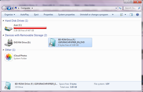

The ISO file that was downloaded in Step 3 is a disc image. In order to use this ISO file; it must be mounted to a virtual drive on your PC. As shown in the picture above, mounted in virtual Drive (F:)
If you are unsure how to do this; try this helpful article on Mounting an ISO.
Once the ISO is mounted, copy all the files to the memory card.
