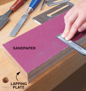

Step 5: Start With the Back of the Blade
Flatten and polish the back first. This process, called lapping, is sometimes overlooked but is important. The cutting edge of the blade is where the two surfaces meet, both have to be sharpened. On the back side, it is the 1/2" or less at the tip that is critical.
The initial grit depends upon the condition of the back of the blade. If it is scratched, rusty, or uneven, start with 400 grit, then 800, working up to 2000 grit or higher at the tip.
In this photo, "lapping plate" is the MDF block with sandpaper glued to the surface.

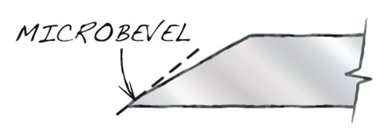

Step 8: Now Hone the Micro Bevel
The final honing stage is the micro bevel, which is a slightly steeper bevel (about two or three degrees) right at the tip. This will be the sharpest, most finely honed part of the blade. The good part is that later, when re-sharpening, this is the only part of the blade you will need to re-touch.
Some honing guides have an additional setting for this micro angle. Some craftsmen do this final stage by hand. I usually do it by placing a couple of square pieces of Formica, or some other thin sheet material, under the wheel of the honing guide. Raising the wheel only makes the angle steeper by a few degrees.
