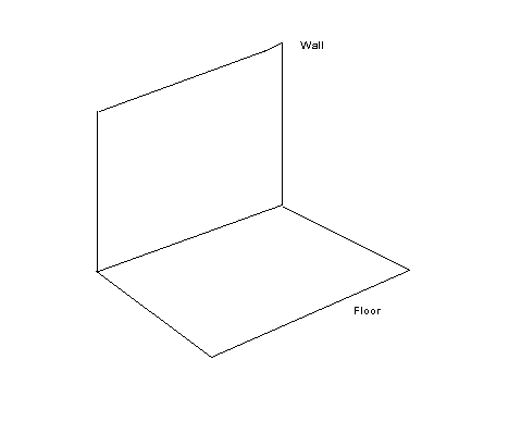

This is the hardest part of all. You can use either a wall or a high-walled metal tray. Tray's work well because they keep the plastic warm while making.

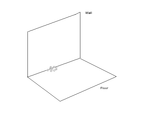

Place ~ 5 pellets against the wall and set a hairdryer to it's lowest speed and highest heat. heat the plastic until it goes clear. I haven't used hot water because this works so well for me.
Step 2: More!!!

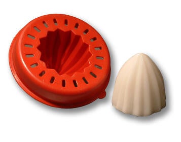

You should end up with something like the picture below. a clear glob.
Next, push more pellets into the mass like in the second picture.
Then, heat and repeat!
