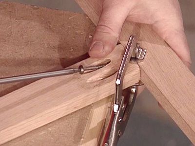

The third photo shows one way you can screw wood together with pocket hole screws. The screws have a square drive and a built in washer -- so it effectively a clamp when it tightens.

Step 2: Drill the Holes and Screw the Wood Together
Mount the stock that you want to connect together in the jig and drill the holes.
Since you are drilling in the back of the wood, you will never see the screw from the front.
It takes the same amount of time to drill the holes, but it makes the project go together really fast. You don't have to use a ton of clamps. You can get by with just two.
