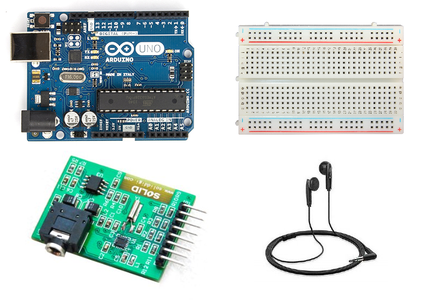

Step 1: What You Will Need
For this tutorial you will need:
  • Arduino uno
  • Breadboard (or breadboard shield)
  • Si4703 FM Board
  • Headphones
