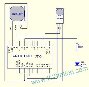

Step 2: Hardware Schematic Diagram

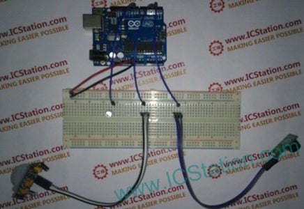

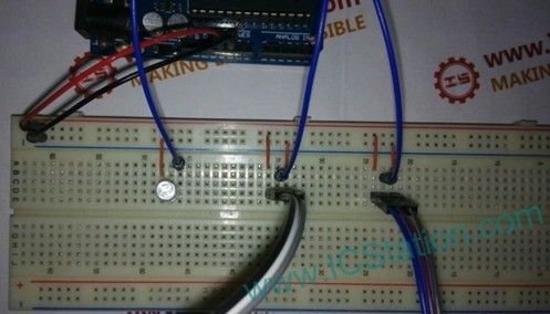

Connect +5 power and GND to bread board. The red jumper wire uses as power line and black jumper wire use as ground wire.
Step 4: Put the Highlight LED Emitting Diode and Pin Header on the Bread Board
Step 5: Connect 2 PCS 3P Dupont Line to the Buzzer Module and Human Infrared Sensor Module
Step 6: Connect the Buzzer Module and Human Infrared Sensor Module to the Bread Board
Step 7: Connect the The Signal End
Connect the the signal end of highlight LED emitting diode, buzzer module and human infrared sensor module to the Arduino board
Step 8: Connect the Power End and Ground Wire End
Connect the power end and ground wire end of the components to the positive and negative pole of bread board
