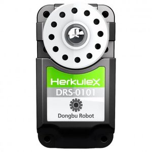

Motors:
19 smart servo Herkulex motor.

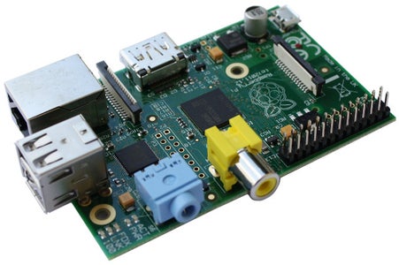

Micro-controllers:
  1. Arduino Mega: it's used to control the servo motors for the movements of the robot.
  2. Raspberry Pi : it's used for the image processing and voice interaction.
