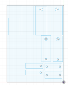

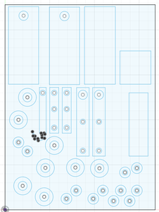

Step 3: Implementing Design
Step 3 included implementing the design into CAD so that I could visualize the design. The red boxes represent syringes, the grey pieces represent cardboard, and the holes are where they would be connected. I included a Fusion 360 sketch of the design, the dxf file of the sketch was used to laser cut the cardboard.

In addition to designing the hydraulic crane, there was also a cube to design. At first, the idea was to have a U channel the hydraulic crane had to hook onto, but after we implemented the design, I realized it was printed with high infill, leading to a greater weight, and it was hard to hook onto. Thus, during the second iteration, the cube was made a lot lighter, and easier to grab. In addition, the connecting tubes of the hydraulic crane were also printed with high infill, making them extremely heavy, especially when supporting the front arms. This led to the design of a hollow tube connecting the arms. Lastly, I also designed cardboard rings that were hot-glued to the tubes, with arms between them, to ensure the arms wouldn't slide on the tube.
