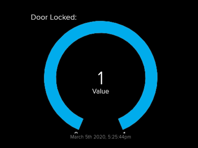

Step 1: How to Make Sure I Locked the House?
I'm constantly having a problem - did I lock the house? I had to go home and make sure of it many times.

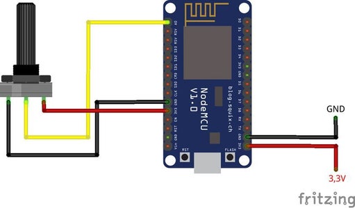

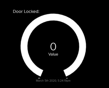

For the sake of this problem, we invented a smart lock. The lock contains a potentiometer, when it rotates to its positive end (i.e. its value == 1024), we will know that the house is locked. Otherwise, it is open.
We connected a potentiometer to the esp8266 component and presented the information in the Adafruit IO dashboard we created.
1. Install ESP8266 Board using that guide: https://randomnerdtutorials.com/how-to-install-esp...
2. Connect the potentiometer to the ESP.
3. Creat new feed in the Adafruit IO, and content a sensor to "feed" it (look at the code to understand).
4. Creat new Dashboard, let us call it - "smart home". for example, https://io.adafruit.com/May811/dashboards/smart-home
5. Add a block type Gauge to your dashboard, with the values 0 and 1.

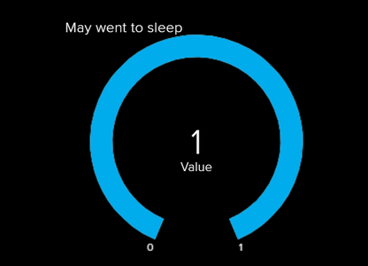

Step 2: Tell Your Mom You're Sleeping
Another problem I face now that I'm away from home is that I keep forgetting to let my worried mother know that I went to sleep, so she can't tell whether I'm home safe or away with friends.
We belt a smart extension to a pillow. using a light sensor, we are able to tell whether a person put his head on the pillow
1. Connect the light sensor to the esp.
2. Creat new feed in the Adafruit IO, and content a sensor to "feed" it (look at the code to understand).
3. Add a new block from type 'Gauge' to your dashboard, with the values 0 and 1.
The materials:
1. esp8266
2. Light Theremin
The Arduino code is attached.

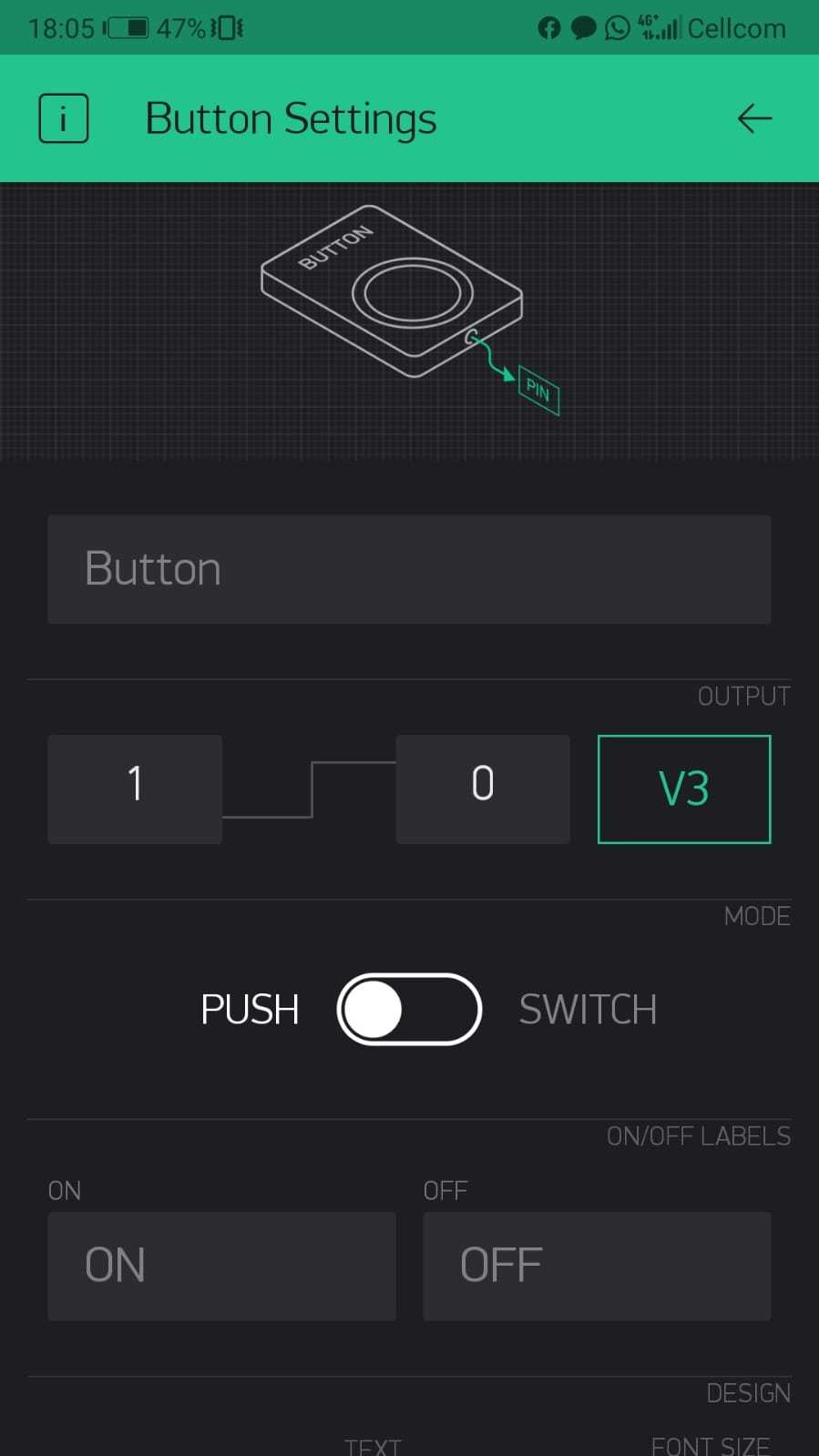

Step 3: Beeper - Make Sure You Are Always Achievable
Another problem I have had since leaving home is that when I study I am not available on mobile, and my mother is very concerned when I do not answer her for a long time.
We decided to give my mom a way to get me when I'm not available.

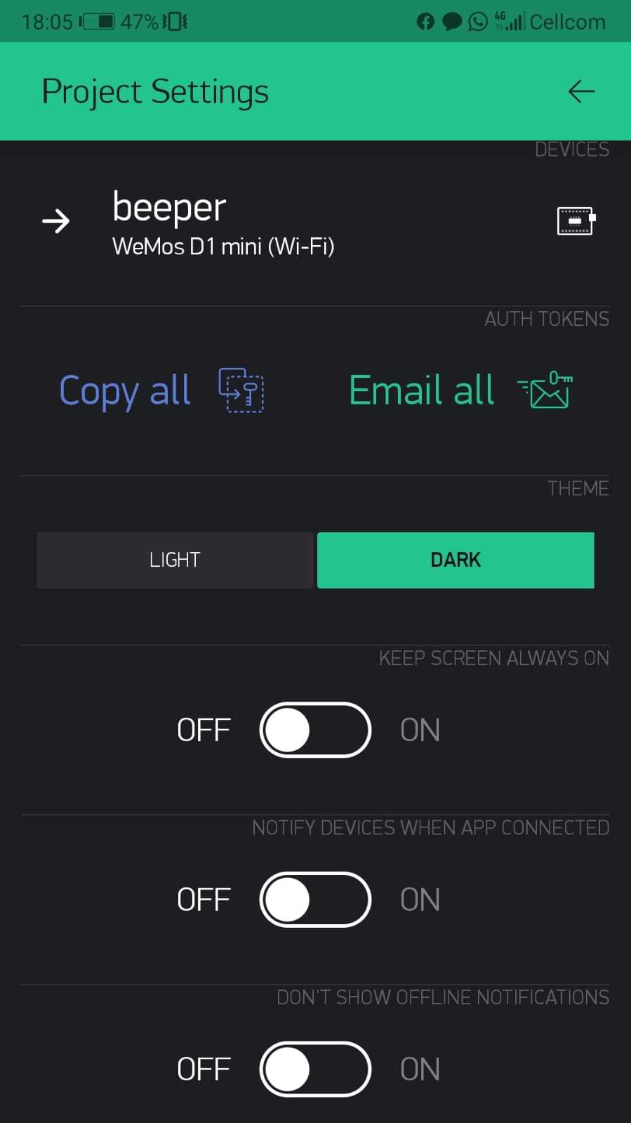

A LED bulb is connected to a Wifi component, when my mom looks for me she will just turn on the LED from the Blynk app, I will notice it and contact her, that way I do not have to be constantly available on mobile.
1. Connect a Led to your esp8266 device.
2. Build a Blynk project:
a. Configure the app to be based on your board (in our case, Wemos mini 1)
b. add a button
c. See attached photos for configuration
3. The Arduino code attaches
4. press play in the project and run the code, and there you go.

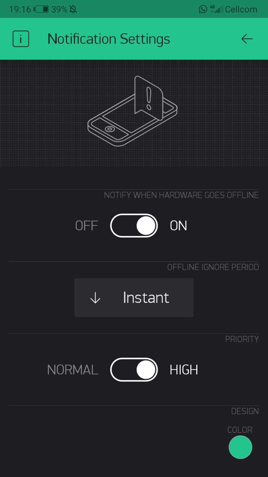

Step 4: Know Who's Coming

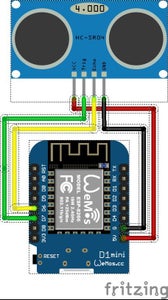

When I moved into my own apartment, I began to feel insecure when I was home alone. We found a solution for this. Every time someone approaches my door, I get notified about it. That way I'll know there is someone at the door, whether I knew of his arrival or not. I'd know to get up to open to guests even if I didn't hear them ringing and protect myself from unwanted guests.
1. Connect an ultrasonic sonar sensor to your esp8266 device.
b. add a notification widget.
3. Locate your sensor outside your door.
4. The Arduino code attaches
5. press play in the project and run the code, and there you go.
