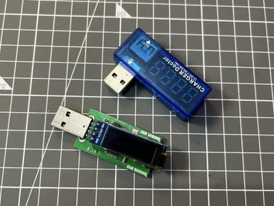

A lot of power meters available in market which delicately made to work with 5volt charger power. The maximum ratings of my commercial one is 7v at 2amps. Now I want to use this USB charger doctor with my fast charger but it is not compatible at all. That’s why designing of this DIY charger came into my mind. My fast charging adaptor goes upto a rating of 80watts. A voltage divider network is used to measure the voltage upto 20volts with a current rating of 5ampere. I want to display the real time readings of this USB doctor on a small display and I choose atmega328p as a microcontroller and SSD 1306 128x32 OLED display of it.

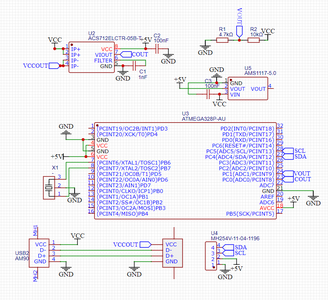

Step 2: Circuit Diagram:
I made this circuit using EasyEDA because it is very compatible to JLCPCB. I used a 5v linear step down convertor to power the microcontroller and other peripherals. rather connecting pin headers of Arduino Uno I designed a circuit which has same properties using the microcontroller IC and 16MHz crystal.

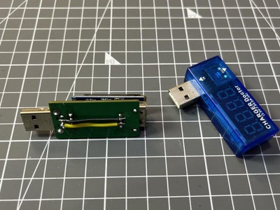

All the connection details are given here in the schematics. Keep one thing in mind, If you want to use this USB charging doctor with fast-charger then datelines of USB need to be connect to each other. Phone gets an interrupt using these data-lines when a fast charger is detected.

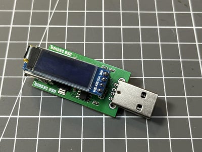

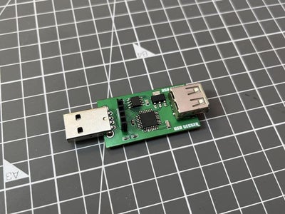

I made a really small PCB having microcontroller on one side and on board pin headers for the small screen. One male and female USB connector, to give power to the system and other one for the power output. I will recommend to use USB 3.0 socket because they are more durable and has very good connection approach.
You can download the Gerber files from here, my PCB is made using FR4 material and HASL finish which costs me around $2 for the 5 piece. You can also use SMT assembly service offered by JLCPCB at a very low cost starting from just $8. Sign-up now to JLCPCB and get free coupons of worth $54 as new user.

This is a plug and play device, the real time readings can be seen on the screen once powered by any source. This USB device is working very well with fast charger. I have shared the updated schematics and Gerber files with you so no need to connect external data wires. Try JLCPCB for faster and Low cost PCB and we will see you next time with an another tutorial
