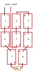

There are 8 batteries arranged in two rows of three and one row of two. All batteries are welded by their tabs to each other, with the exception of batteries 7 and 8, which are joined by the fuse. It is easiest to build 4 subassemblies and then combine to build the final pack.
Step 3: Build Battery Pairs
Build three subassemblies by welding batteries 1 to 4 (+ to -), 2 to 5 (+ to -), 3 to 6 (- to +). Remove one of the tabs from each of the ends to be welded. Place the batteries side by side and weld the remaining tab to the other battery. Carefully fold the tab in half to create an in-line package of two batteries.

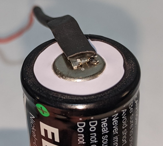

Weld batteries 7 to 8 (+ to -) via the 10A fuse. Fold the tabs over where welded to the battery. Insert the fuse leads into the folded tabs. Use a small screwdriver blade to tighten up the tab around the fuse lead on each end and then weld both the loose tab end to the battery and place a few welds where the tab wraps around the lead. Trim leads as necessary.
Step 5: Attach Leads
Solder a 110 cm black wire to the negative tab on battery 1. Solder a 160 cm red wire to the positive tab on battery 5. Slip heat shrink tubing over the tabs and shrink with heat.

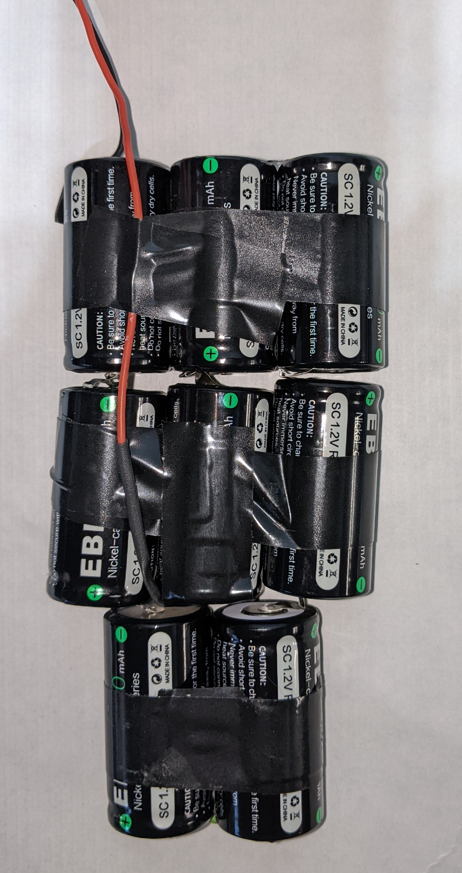

Weld the subassemblies into the final assembly as shown in the diagram. Black electrical tape can be used to bind the batteries together. Additionally, tape should be placed over the positive end of battery 5 to prevent shorting with batteries 7 and 8.

Measure the voltage at the stripped ends. It should measure 9.6VDC or a bit higher since there is no load (also depends on charge in batteries). If not, verify that all the batteries are connected in the proper order with the proper polarity and that the fuse is solidly connected to the two batteries.

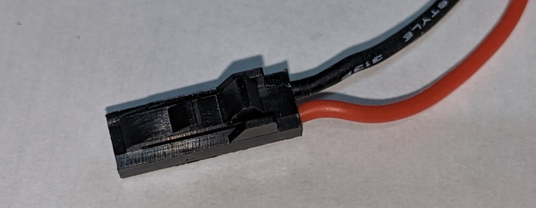

Crimp on the female pins with the crimping tool. Insert pins into the connect positions as shown. A standard Dupont connector without the latch can be used but caution must be taken when plugging the battery into the PC Convertible to use the proper polarity.

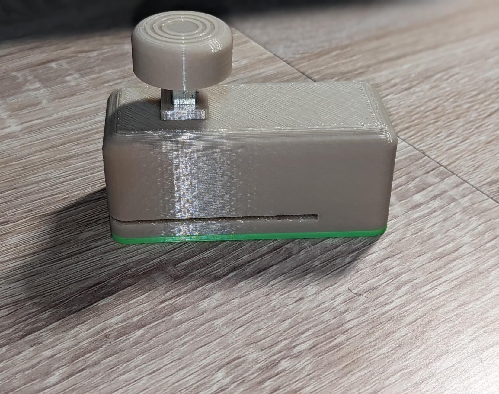

Use hot glue (low temp is best to not melt the case) to attach the battery pack to the top of the case (similar to IBMs use of glue in the original battery). Be careful to not block the vent slits in the top. Use super glue to attach the bottom of the case to the top.

Ready to plug in and use. Note that if you used a normal Dupont connector, the positive (red) pin is closest to the battery.
