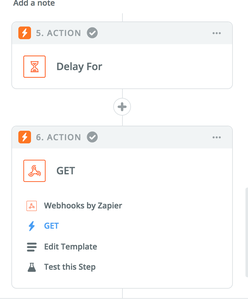

(5) ACTION - DELAY FOR
Let the user time to reply to the email.
- If the user clicks on the link: call (run) the GoogleScript -
ApproveCurrentEvent
(Hence The room is removed from the 'Rooms to delete' list, and the room is still marked as occupied.)
(6) ACTION - GET
After 5 minutes, Zapier calls (runs) GoogleScript -
DeleteCurrentEvent
- If the user didn't click on the link
> Checks if the room ID is in the list 'Rooms to delete'
> it just removes the event.
