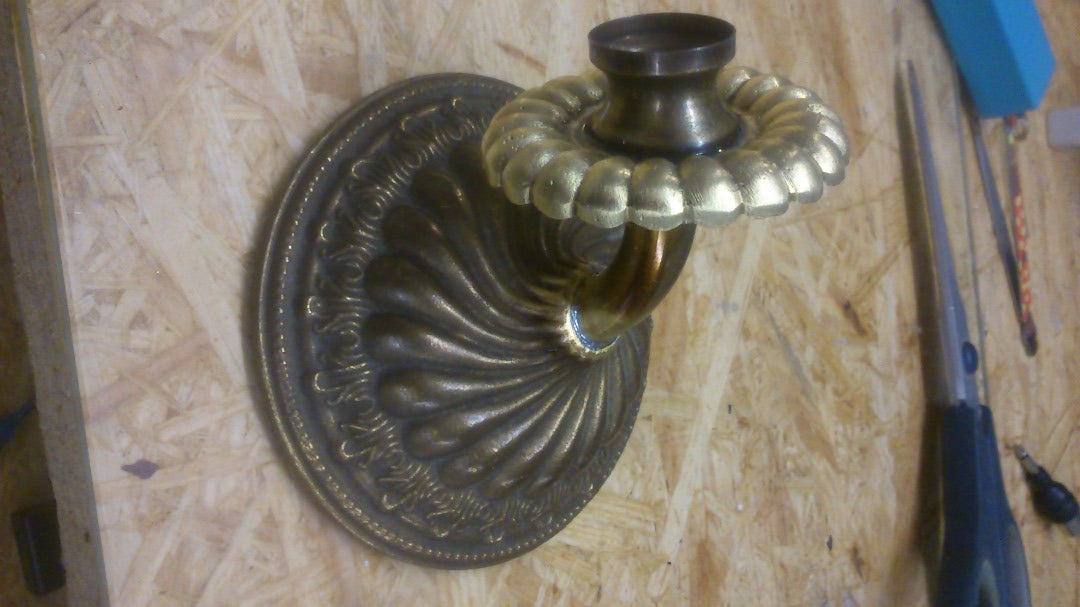

Step 1: The Rotating Holders for the Geissler Tube
Glue the Ball-bearings and the Brass Divides in the Brass Rosette with 2 K Resin.

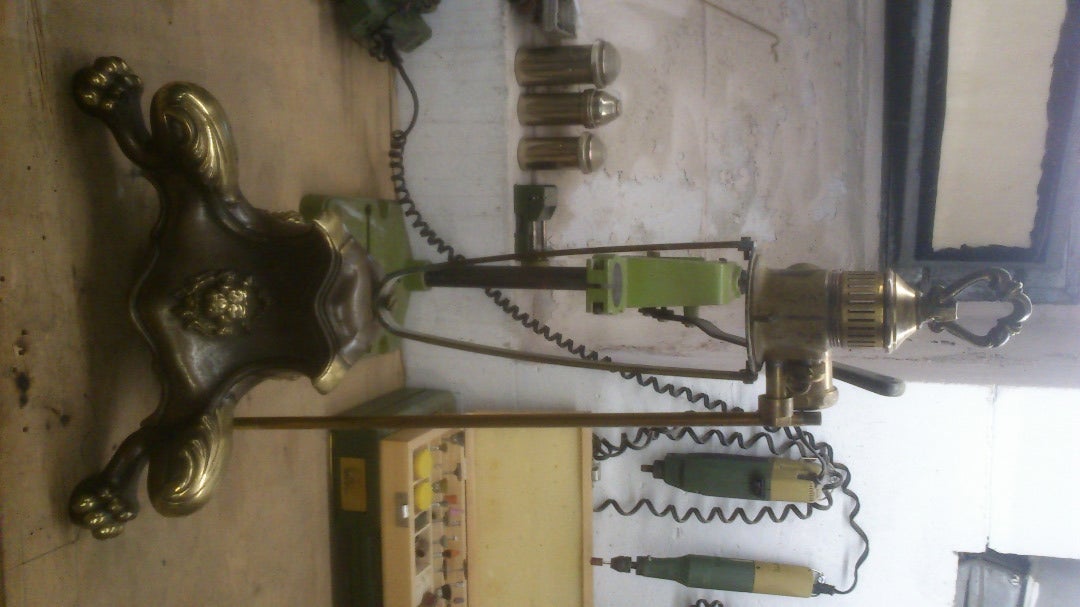

Step 2: The Feet
Sawing of the feet . Here was an old , bulky lamp base made of solid Brass cast excellent. Ask not what it was a hellish work and my lab was covered with brass dust.

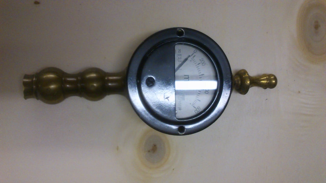

Step 3: The Measure Instrument
We take an old case of a pressure gauge.
Remove the pressure gauge and replace them with the amperemeter. This device shows later to the power of the Tesla transformer. A small 3mm, orange LED for illumination and a resistor for 12 Volt. Some Brass Ornaments and ready ;)

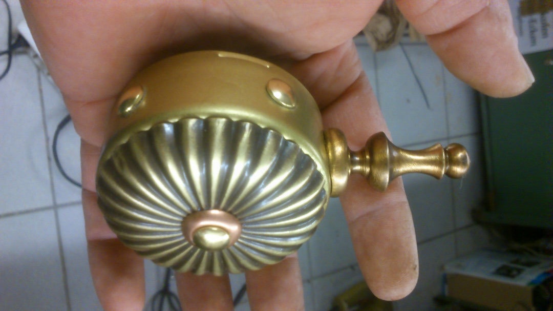

Step 4: Solder the Frames for Neon Lamps
Now we take small Brass Frames and solder them on a Brass Ring. There are sitting later the small Neon Glow lamps. All Ok ?

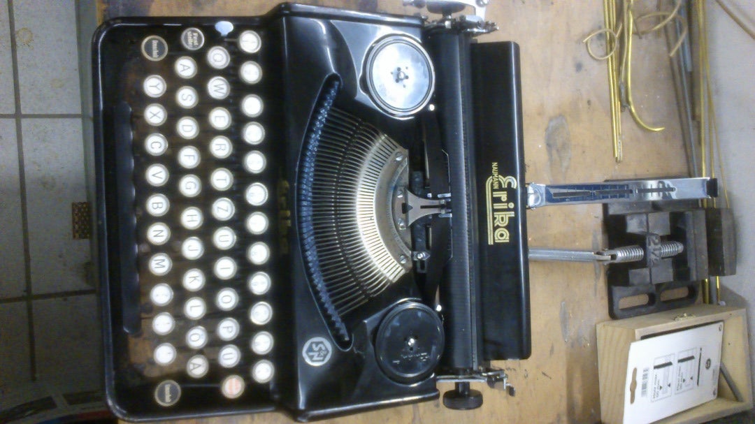

Manufacture the keys . Here I had an bestowed , old typewriter to help . Without further ado, the thing cannibalized and serve me the keys . Cut the buttons below the top and stick this in so-called " banana plugs ". 6mm brass tube serves excellently as a guide tube.

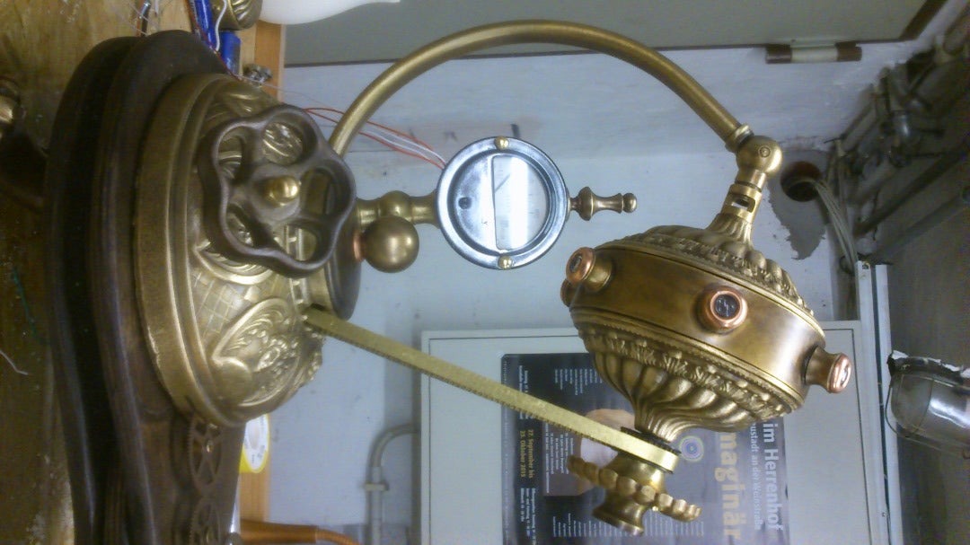

Step 7: Housing
Now we construct the Housing with Poplar Wood. The shape is pure fantasy
but I think very appropriate . Paint it with Wood color as you like.
An old hand wheel made of steel will be rebuilt and serves later as a controller for the cage speed. Glue ansuitable potentiometer a the end of the Screw. The UV-led is sitting in the Middle. So it can shine to the Uranium Glass Spiral of the Geissler Tube an let it Glow.
