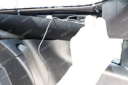

Step 8:
Remove the backseat panel, pillar panel, and roof panel. You'll need to route the yellow wire in through those locations up to the 3rd brake light.
Step 9:
After you open the panels, you can see the existing 3rd brake light's yellow wire. Draw the LED rear fog light's yellow wire up behind the panels and tap it to the OEM 3rd brake light.
Afterwards, just close all the panels, put the trunk liner and all the components back.
