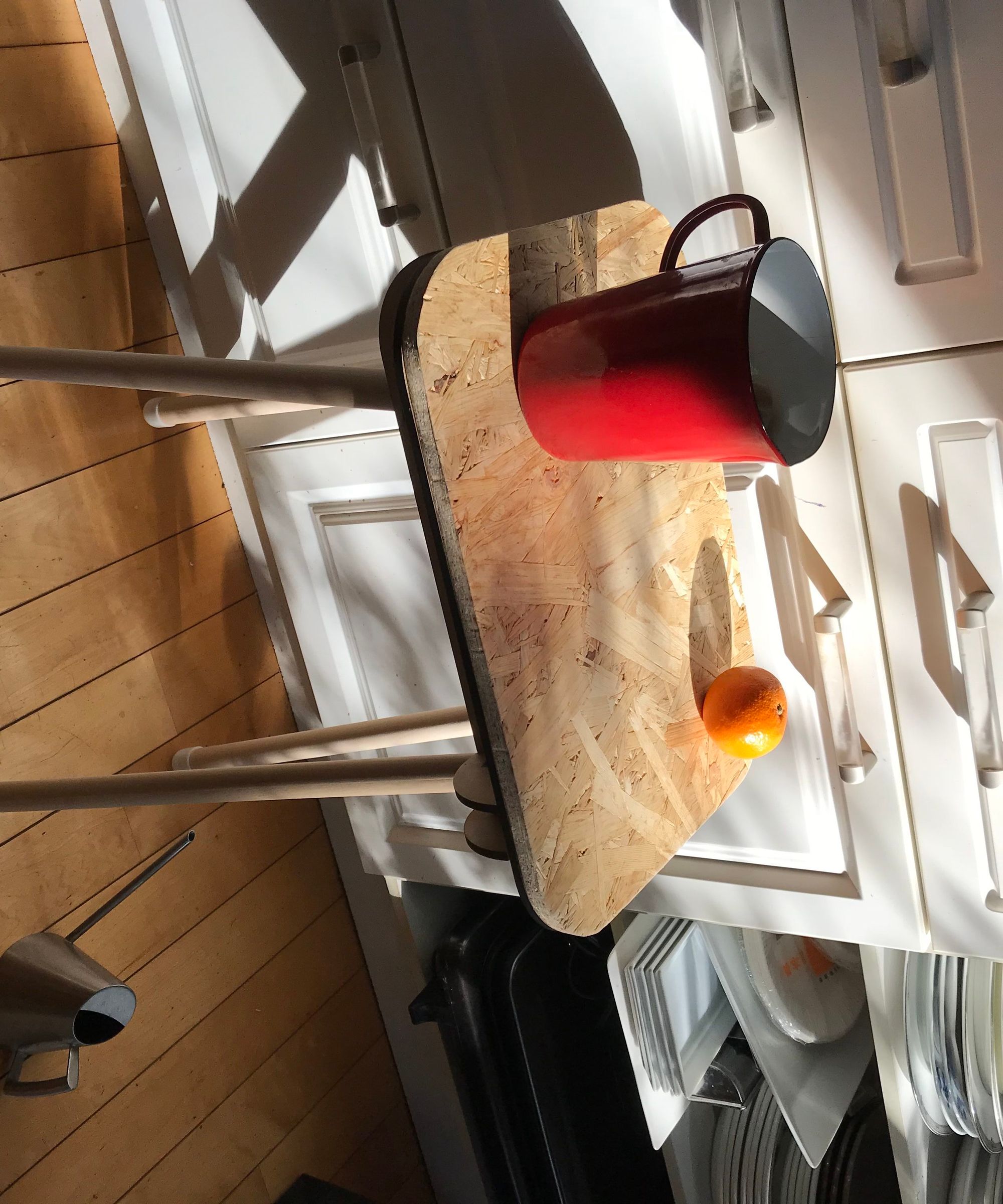

Step 1: CUT
1.Cut the pipe leg in half.
2.Cut the wood leg.
3.Make a hole to guide where to screw.
4.Cut the seat of FROSUTA STOOL in circle with the radius of 15mm by using hole-saw.
Step 2: 3D PRINT
5.Output the part to joint the stool leg and the seat part.
Step 3: Now You Have All the Materials to Build.
・FROSUTA STOOL's seat(with hole) ×1
・MARIUS STOOL's seat ×1
・wood leg ×2
・pipe leg ×1
・cap (from MARIUS STOOL) ×1
・3d printed junction ×1
・screw
Step 4: PUT IT IN
6.Put the joint into a hole.
7.Plate the MARIUS STOOL to the joint.
8.Screw.
9.Insert the pipe leg to the joint.
Step 5: SCREW
10.Screw the wood leg to the pipe leg.
