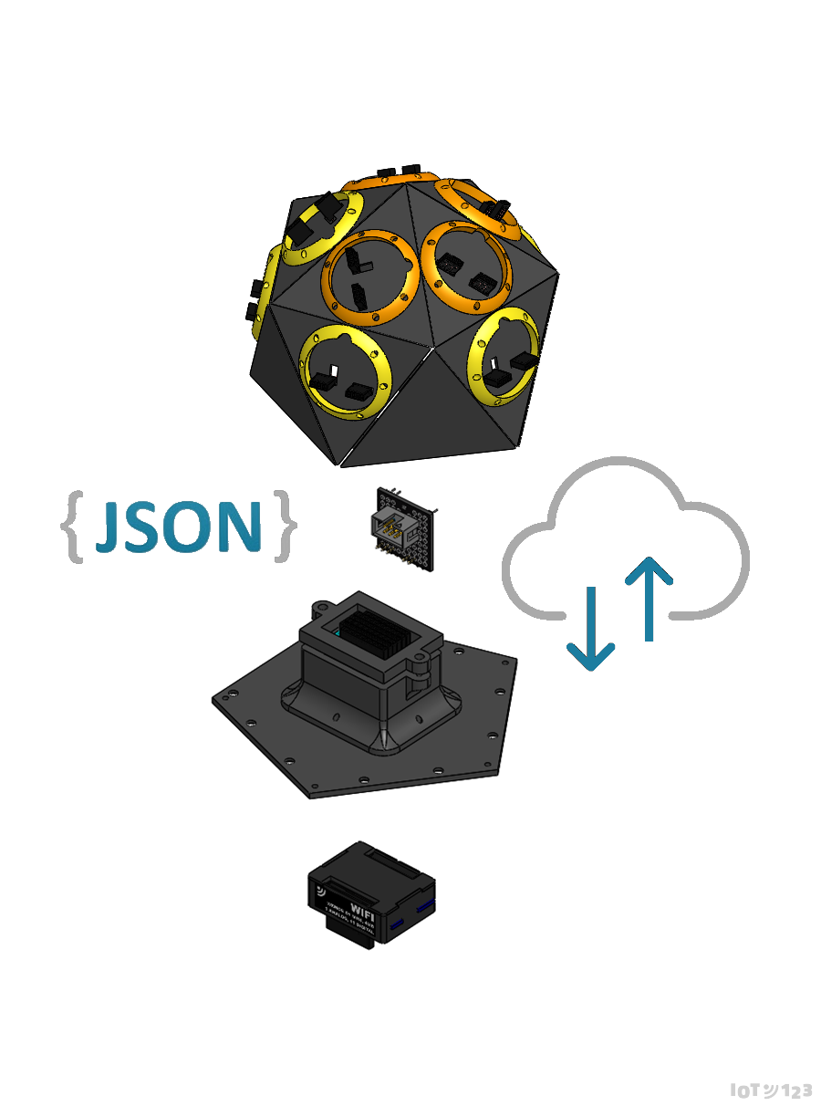

The ASSIMILATE IOT NETWORK is a set of protocols that allow easy integration of sensors, actors, thing nodes and local brokers with the outside world.
This Instructable is instructions for the instructions; it indexes all the different projects and points to where the articles and resources are for each project.
FEATURES AND VISION
Currently the Slaves (sensors and actors) are self contained and rely on convention based I2C messages to read properties or act on commands. The Master picks up the metadata and properties from slaves and sends it to a MQTT broker. It also starts a webserver and serves JSON files that can be edited to configure the master and customize the metadata/properties that eventually is consumed by Crouton. The individual sensors/actors are read/commanded via Crouton without the master having any prior knowledge of what the slaves do.
One of the goals of the ASSIMILATE IOT NETWORK is to customize AssimilateCrouton so that mashup editors served from the IOT NODE webservers (see following hubs), are added as webcomponents that will give complete control of what the thing does i.e. the master is not programmed, the slaves have basic feature sets but the Crouton dashboard embeds all the business rules needed to run the thing!
The Crouton fork is seen as an option for decentralized control/configuration of things. In essence any MQTT client/GUI combination can administer your things, as every function (sensors and actors) are exposed as MQTT endpoints.
CROUTON
Crouton. http://crouton.mybluemix.net/ Crouton is a dashboard that lets you visualize and control your IOT devices with minimal setup. Essentially, it is the easiest dashboard to setup for any IOT hardware enthusiast using only MQTT and JSON.
The ASSIMILATE SLAVES (sensors and actors) have embedded metadata and properties that the master uses to build up the deviceInfo json packet that Crouton uses to build the dashboard. The intermediary between ASSIMILATE NODES and Crouton is a MQTT broker that is websockets friendly: Mosquito is used for the demo.
As the ASSIMILATE MASTER (see following hubs) requests properties, it formats the response values in the required format for Crouton updates.

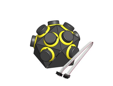

Step 5: ASSIMILATE SENSOR HUB: ICOS10 GENERIC SHELL (IDC) ASSEMBLY
This is an improved (circuit robustness) version of the ASSIMILATE SENSOR HUB: ICOS10 GENERIC SHELL (HOOKUP WIRE) Assembly. It assembles quicker and has a higher quality circuit, but costs more (~$10 extra if supporting 10 sensors). The main feature is it is very modular now: panels and cables can the replaced/customized without the need for de-soldering/soldering.
RESOURCES
Instructable, 3D Parts
Step 6: IOT123 - ASSIMILATE SENSOR HUB: ICOS10 GENERIC SHELL (HOOKUP WIRE) ASSEMBLY
This is the original Shell assembly. Use the IDC one above.
RESOURCES

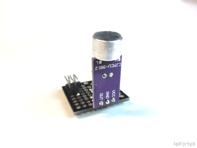

Step 7: I2C MAX9812 BRICK
This is the circuit that is used by the following ASSIMILATE SERSOR.
This I2C MAX9812 BRICK dumps 3 sound sensing properties:
  • audMin (0-1023) - lowest value inside the 50ms (20Hz) sample window
  • audMax (0-1023) - highest value inside the 50ms (20Hz) sample window
  • audDiff (0-50) - a value derived from the difference of aMin and aMax
RESOURCES
Instructable, Repository
Step 8: ASSIMILATE SENSOR: MAX9812
This build is based on the I2C MAX9812 BRICK.
If you need adjustable gain, I recommend swapping this sensor out for the MAX4466.
This ASSIMILATE SENSOR dumps 3 properties:
  1. audMin (0-1023) - lowest value inside the 50ms (20Hz) sample window
  2. audMax (0-1023) - highest value inside the 50ms (20Hz) sample window
  3. audDiff (0-50) - a value derived from the difference of aMin and aMax
RESOURCES
Instructable, Repository, 3D Parts

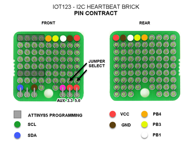

Step 9: I2C HEARTBEAT BRICK
This I2C HEARTBEAT BRICK indicates whether the ATTINY slave is alive, also the I2C traffic, and has one property:
  • STATUS ("ALIVE")

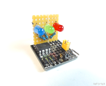

Step 10: ASSIMILATE ACTOR: HEARTBEAT
This build is based on the I2C HEARTBEAT BRICK.
This ASSIMILATE ACTOR has one property:
  • STATUS ("ALIVE")
PB1 (white wire, blue LED) indicates ATTINY health.
PB3 (yellow wire, green LED) toggles with I2C requests from the master.
PB4 (orange wire, red LED) toggles with I2C receiving from the master.
RESOURCES

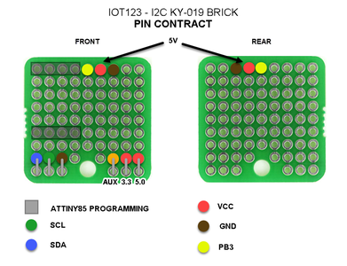

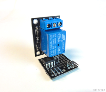

Step 12: I2C KY019 BRICK
This is the circuit that is used by the following ASSIMILATE ACTOR.
This I2C KY019 BRICK is the first of the ACTORS, and has one read/write property:
  • Switch (true/false).
RESOURCES
Step 13: ASSIMILATE ACTOR: KY019
This build is based on the I2C KY019 BRICK.
If you need 2 channels, I recommend swapping this actor out for the 2CH RELAY BRICK.
This ASSIMILATE ACTORS, and has one read/write property:
RESOURCES

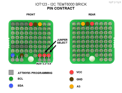

Step 14: I2C TEMT6000 BRICK
This I2C TEMT6000 BRICK dumps 3 properties:
  • Ambient Illumination (Lux)
  • Ambient Illumination (Foot Candel units)
  • Ambient Irradiation (Watt per Square Metre).
RESOURCES

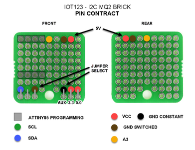

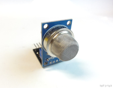

Step 16: I2C MQ2 BRICK
This I2C MQ2 BRICK dumps 3 properties:
  • LPG (Parts Per Million)
  • CO (PPM)
  • SMOKE (PPM).
RESOURCES

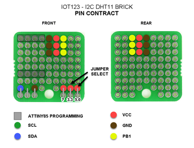

Step 18: I2C DHT11 BRICK
This I2C DHT11 BRICK dumps 5 properties:
  • Humidity (%)
  • Temperature (C)
  • Temperature (F)
  • Temperature (K)
  • Dew Point (C).

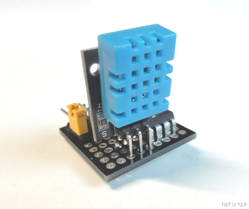

Step 19: ASSIMILATE SENSOR: DHT11
This build is based on the I2C MQ2 BRICK.
This ASSIMILATE SENSOR dumps 5 properties:
  • Humidity (%)
  • Temperature (C)
  • Temperature (F)
  • Temperature (K)
  • Dew Point (C).
RESOURCES

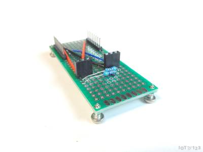

Step 20: I2C PCB RAILS
Where durable casings are not needed, the ASSIMILATE IOT NETWORK SENSORS and ACTORS can stack more efficiently and with less resources and effort, straight onto minimalist rails. The encasing cylinders can be used (as shown in this build) or the underlying bricks can be plugged in directly.

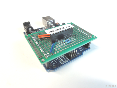

Step 22: I2C BRICK MASTER JIG
While developing the ASSIMILATE SENSORS and ACTORS, I keep a UNO handy for sending adhoc I2C commands to the prototypes being developed.
One of the benefits of the I2C BRICKS is the standardized pinouts. Rather than using breadboard wires each time (see the Fritzings), a sturdy lo-tech shield is used.

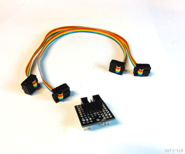

Step 23: IDC CABLE TESTER (6 WIRE)
In developing the ICOS10 ASSIMILATE SENSOR HUB, I needed to verify the cables I was creating. The verification was to check continuity between the sockets and isolation between the wires. The design I came up with used DIP switches to change between continuity and isolation tests. As I expect to have a different board for each tests (the DIP Switches aren't built for constant use), the two circuits can be hard-wired without the need for DIP Switches,

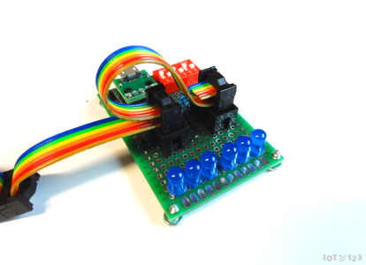

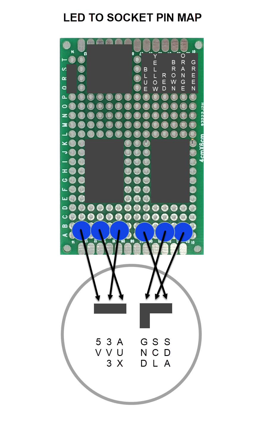

Step 24: ICOS PANEL CIRCUIT TESTER
In developing the ICOS10 ASSIMILATE SENSOR HUB, I needed to verify the panel circuits as they were made. Also as the pins were being soldered on the 3P headers, I wanted a 3P male pins inserted in them to stop any deformation during soldering. Also key to this design: I had already developed a circuit tester for the 6 wire IDC cables.

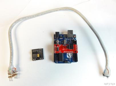

Step 25: ATTINY85 ONBOARD PROGRAMMING JIG
On the BRICK designs, I have mentioned the through-holes adjacent to the ATTINY85 have been left unused, to enable a pogo pin programmer while the DIP8 is soldered to the PCB. This is that pogo pin programmer. This really is just an adapter lead from an existing programmer's DIP8 DIL socket to the 6 x 4 hole spacing pogo jig to use on the PCB.
